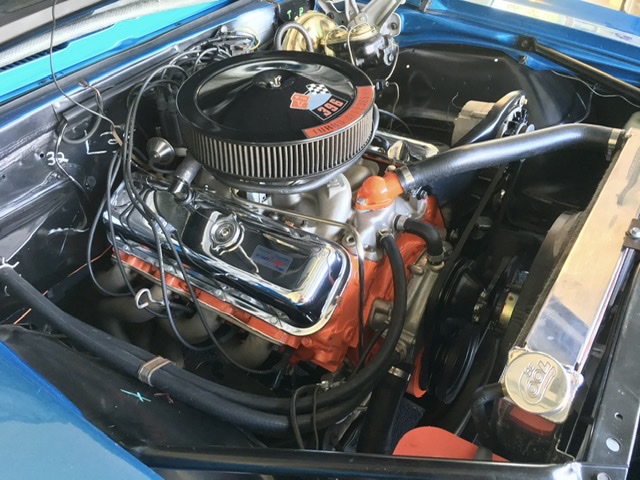

What are you guys doing to recondition your manifolds? I'm cleaning up the extremely nice 402 manifolds before I reinstall the motor in my '71 Impala...it's a low mile CA car so there's just a light coating of surface rust to deal with. I remember using Calyx back in the day but curious what you guys prefer in 2020.

Dropped my original exhaust manifolds to a friend's shop and he sent them for a few rounds in his block tumbler using some steel shot. Gotta say the exhaust manifolds came out looking great. When things warm up here, I'll spray them with a high temp clear to keep them looking this nice. Here's the before and after shots and some pics of the tumbler he uses for cast iron parts cleaning.
