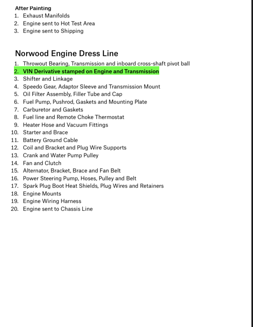

Here's my list for date coding engine components based on information provided by John Hinckley at the CRG.
Date coded components installed at the Flint Engine Plant would pre-date the engine build date stamped on the block pad.
Date coded components installed at the Norwood Engine Dress Line would pre-date the cowl tag build date although there are some documented exceptions to that.
My understanding is that dated components can pre-date the engine or cowl tag build dates by approx. 3 months.
At Norwood, the vin was stamped on the engine and transmission just after they were mated on the Engine Dress Line.

So was the car ready when the engine made it to the Dress Line in normal situations? Was the cowl tag already on the car?
Very good read:
http://www.camaros.org/assemblyprocess.shtml#fisher
Yes, the completed engine and transmission were sent from the Engine Dress Line to the Chassis Line for installation in the subframe. The completed subframe and chassis components were sent to the Final Line for installation to the body.
Yes, the cowl tag was already on the car. It was installed at Fisher Body during the body framing operation.
The car assembly was like clockwork. Fisher Body did their part in 2 days, Chevrolet took 1.5 days for their part....a completed Camaro in 3.5 days. Pretty cool!
