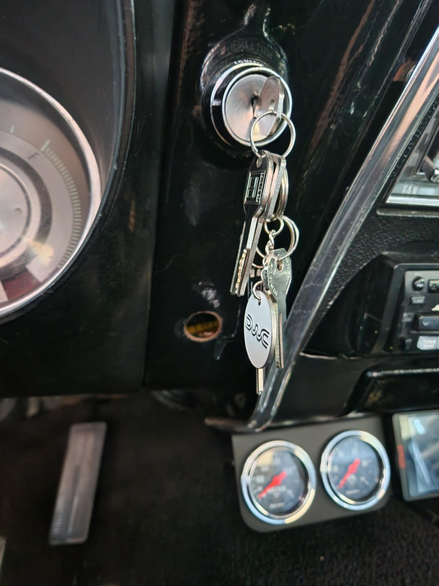

What's up with the A/C vent in the dash, Wes? Was this a factory Muncie 4-speed car or converted later? Interesting find for sure.
Per the early 2010's owner there was no A/C dash when he sold it in 2015.

Back in 2014, it had the AC holes on the firewall. It would have to have the dash hole too...
