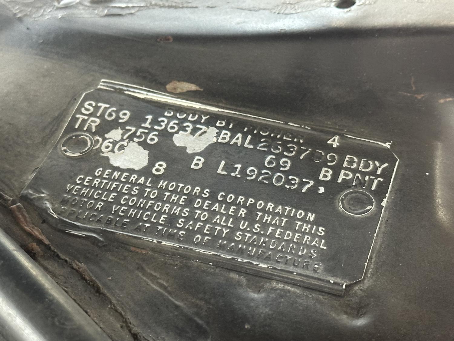

Any idea why this presumed COPO sold for $58K in the May Mecum auction? Current seller is trying to flip it for $137k on the Detroit craigslist.

I looked this over while at Mecum Indy. Attached are photos of the trim tag and CE stamped block. I didn't crawl under the car to try and get a photo of the rear stamp. Nothing about it made me think it was a COPO. They only mention the COPO program in the auction listing but don't specifically call this particular car a COPO. I wonder if the current seller will provide a photo of the rear?

Forgot to attach them in previous post.

Thanks, agree that the trim tag doesn’t look consistent with other COPOs.

----Can someone from Texas tell me why the Texas window sticker has a ) for the year? That trim tag is a bit confusing for sure!....Bill S
