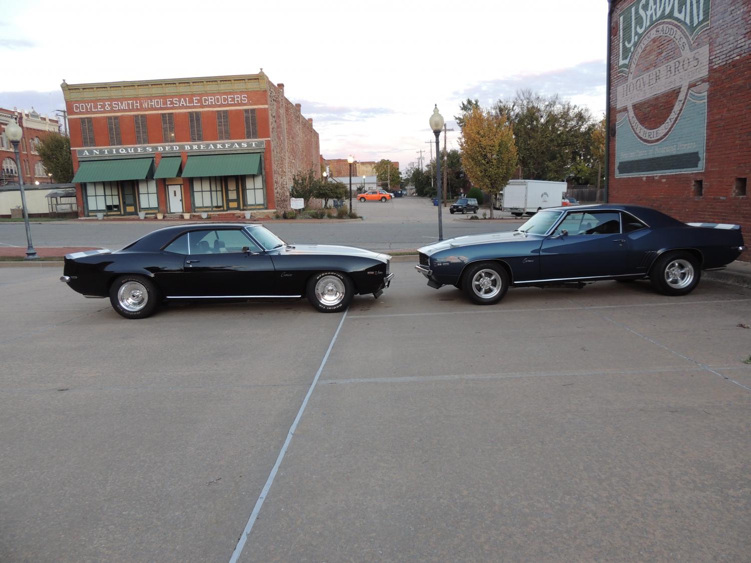

I love Centerlines. Technically not a "day two" wheel, as they didn't come along until 1970 or 71. But a great "day three" wheel.
The looked awesome on my 69 Z, but I sold them when I went back to the original Rally wheels. Caution; despite what the "experts" say, you need hubcentric rings if you go Centerline, or ANY wheel that does not have the same hub diameter of a factory wheel. Period. Mine is the black one.

I recently sold the wheels and tires.
This is from the description when I had them listed.
Rears are 15 x 8.5 with 5 inch backspacing. As you can see from the pics they fit perfectly under inside the wheel wells of my 69 Camaro. I cannot say if they would fit inside a 67 or 68.
Rear tires are 255 60 R15.
Fronts are 15 x 7, also 5 inch backspacing. I ran a .200 spacer (very easy to find) to keep them from rubbing the frame rail on full turn. No rubbing issues at all. Although I am normally not a big fan of spacers, but .200, or even .250 isn’t excessive and I had no vibration issues.

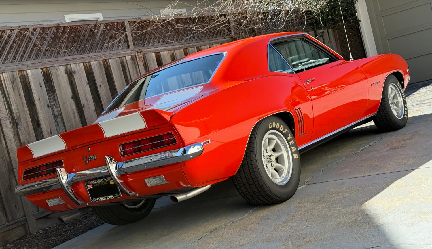

I have BFGs in 215/65 and 255/60 (custom sidewalls to say Goodyear but they are BFG TAs). They are on reproduction Minilites from Trans Am Race Engineering, 15x7 with 4” backspacing and 15x8 4.5” bs. Factory RS fender wells with all hardware and no rubbing
