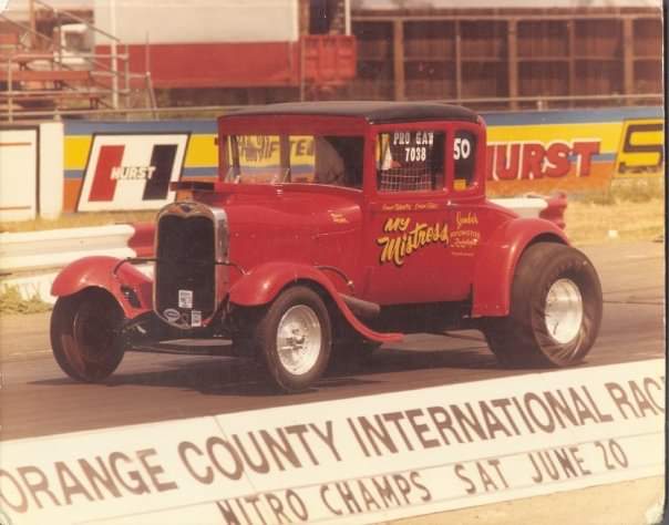

I know this is an old thread but I just found it and wanted to add some information.
Back in the very late 1970's and early 1980's my stepfather raced at Terminal Island/Brotherhood, Orange County International Raceway OCIR and at Pomona. He met and teamed up with Vince "Jumbo" Zamora. Jumbo drove a Red El Camino. I believe it was a 1970. I seem to remember it having a custom weight shifting mechanism in the bed.
I don't know the details but apparently some shady business dealings occurred and Jumbo cheated or stole from my stepfather. Not sure if it was in the form of money or engines or parts.
I now own the car my stepfather raced. It was an all steel full body 1929 model A Ford called "My Mistress". I'm attaching a photo of it in case anyone has interest in the history associated with this story.
I know that doesn't have anything to do with your engine but I wanted to shed some history on Jumbo's Racing Engines in Torrance, CA.
