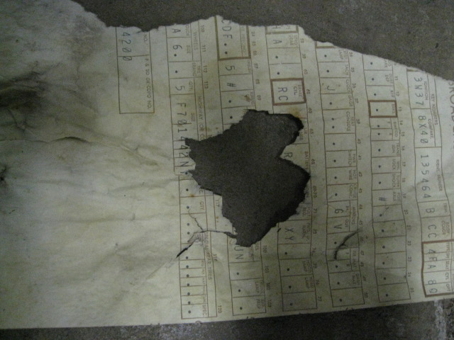

I have had quite a few 67 chevelles built in all the plants and always found a paper build card under the rear seat area listing interior,color etc,has anyone ever seen a kansas built car with the build sheets (full body broadcast)stuck to the inner front fenders?I have seen it on 69 cars but never a 67?thanks

Thats exactly all i ever found in these cars,but i just purchased a survivor 67 ss 396 car that has never been molested or apart and both front fenders still have a build sheet glued inside them and they look like a 69 type broadcast or chassis sheets..

My 69 Chevelle (also built in KC) had the same thing, one stuck to the inside of each front fender. I slid a long slim piece of sheet metal in and got them both off.....they were glued on in only one little spot right in the center of the sheet.

Luck struck again this week i just purchased another orig survivor 67 ss396 car and this one is a baltimore built late car with a full broadcast sheet also,I just never knew they were used in these cars.Ill post a pic tomorrow of it.thanks

The 1st pic is the sheet from the inside fender of my kansas built 67 car..
The 2nd pic is the sheet from my baltimore built 67 car..
