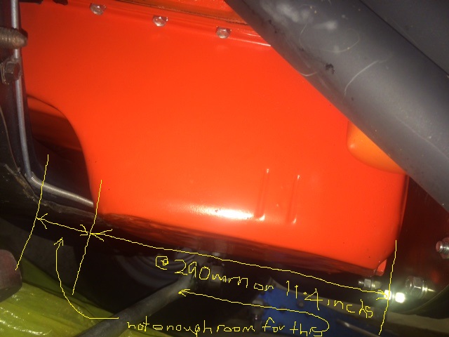

Thanks again for your help. I will order a set of 67-68 frame and engine mounts and then progress through the other required parts.
From the advice I think I need to take a closer look at the oil pan. From what I can make out there should be no difference between a 427 L72 and a 396 L78 oil pan? Unless the oil pan has been modified......would anyone know of any common modification which would affect the clearance of the oil pan to the cross member?
Regards Gavin

Thanks Lee, from what I can see the oil pan I have looks like the first image. But the drain plug on mine is at the back. I suspect it had been moved as when it was stripped it had been brazed in the new position

That's a small block cross member installed backwards

Hello here is some images. I think in comparison to the images posted the oil pan might be over sized?
