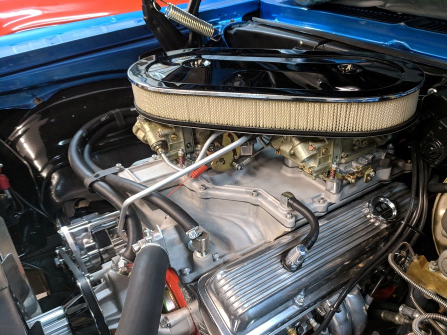

Originally Posted by NorCam View Post
Darrell...
Solid flat tappet but Comp redesigned the ramp speeds with a modern lobe design and tightened the lash up to .016 on this Nostalgia grind. Makes like "no vaccum" either so it'll need a pump installed. Won't know until I've driven or dyno'd this one but it's supposed to wake up the lower end and mid range some and can run 7500 rpm on the top end of a 302.
I've also got this option for the top end if I decide to run some more gear in it. This intake will either be going onto the 302 in the green 69 car or it'll be going on the bigger solid roller motor in my blue 68.
You want a lot of compression and tight cam centerline 106ish and you love that crossram.

Thanks again for the info and such from your Nova build.
Plans are always changing with me and likely due to having a few fresh engines here to choose from. As of now the plan will be to mount the Crossram on the solid roller 355 motor that was just broken in from my 68. It's sitting with 10.5 compression and runs a 254/262 duration solid roller at .582 lift. It'll make some decent power with the 200cc aluminum heads that are mounted up and will flow nicely with the Crossram intake. Here's the Crossram after Mike went through both the carbs and freshened them both over the last couple days. These are NOS 70/71 service date 585 CFM carbs and should work real well on this motor. It'll soon go into the 69 car with an M22 and the 4:10 gearing. More on this over the next couple months as I'll have to juggle a few things around first. The CE 302 will sit off to the side with the original heads, intake and carb mounted up.
