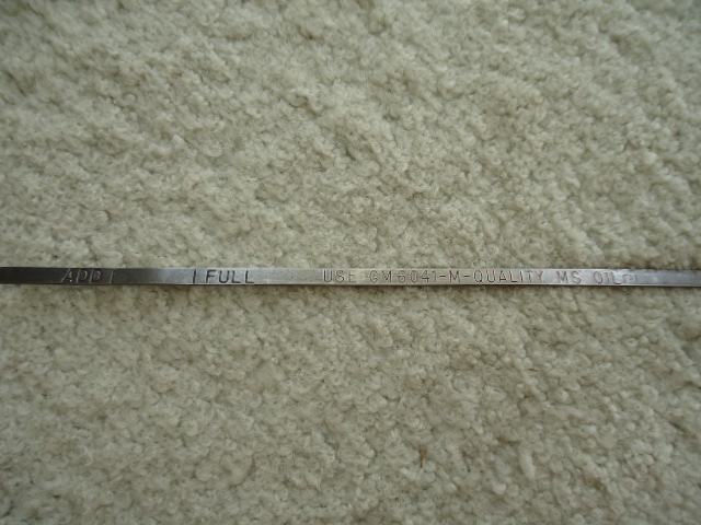

Ok member’s out there. What is the correct Oil Dipstick Handle.
Is it the Round Handle Yellow Tip or the Flat Handle Yellow Tip.
Any help would be greatly appreciated.
Thank You!

Flat handle...Part#3925599,installed on the assembly line as original equipment on:
1968 Camaro-Nova-Chevelle w/396cid.
1969 Camaro-Nova-Chevelle w/396cid. & 427cid.
1970 ALL vehicles w/396cid. & 454cid.
Measures roughly 24-1/4 long.
Shows USE GM6041-M-QUALITY MS OIL E near the bottom of the stick.

I have a dipstick with the GRAY tip. Does anyone know what that is for? Thanks

How long is the gray tip? Sounds like 68 and earlier small block

Top of Handle to dipstick end is 22”.

22" sounds like a 67-68 sbc

I am looking for this exact dipstick and tube.Flat handle...Part#3925599,installed on the assembly line as original equipment on:
Is this one for sale by any chance??

If you're asking me with those photos,I'm sorry no,because it sold earlier this year on this site.
