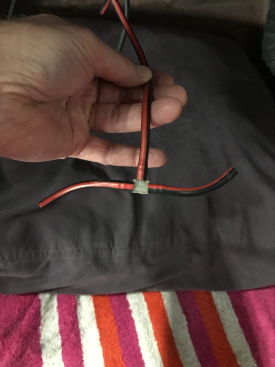

Ok, I need a little help with these ac heater box vacuum lines. Unfortunately, I did not take these off. If I did I would have a ton of pics. I have read the FSM and have got a few clues but really need to understand where the red stripe hose with the “T” goes and where the red hose goes in relation to the top or bottom of the actuator. Or any clues you guys may have.
A12Pilot has been a ton of help with this project....where you been???....RJS 6T9Chrgr you guys have spring on the scene lately with a great round of info. Thanks so much guys super helpful to this novice Mopar guy!!!👍👍😁

This pic help any?
  #124
Old 12-27-2017, 09:47 PM
sixt9rsx33 sixt9rsx33 is online now
Join Date: Jul 2008
Location: NC
Posts: 1,317
Thanks: 51
Yes, very. After I posted the question I started googling and ran across a thread with one of these pictures. The picture with the time delay wires connected is very helpful.
Thanks very much!
