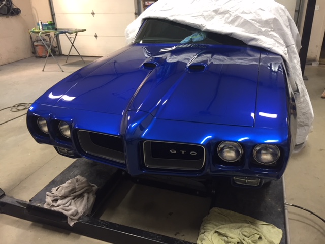

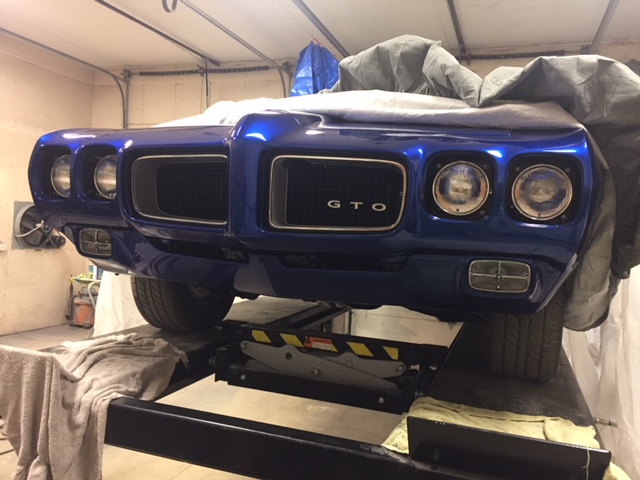

Almost ready for the first voyage.
Looking for the next project.
