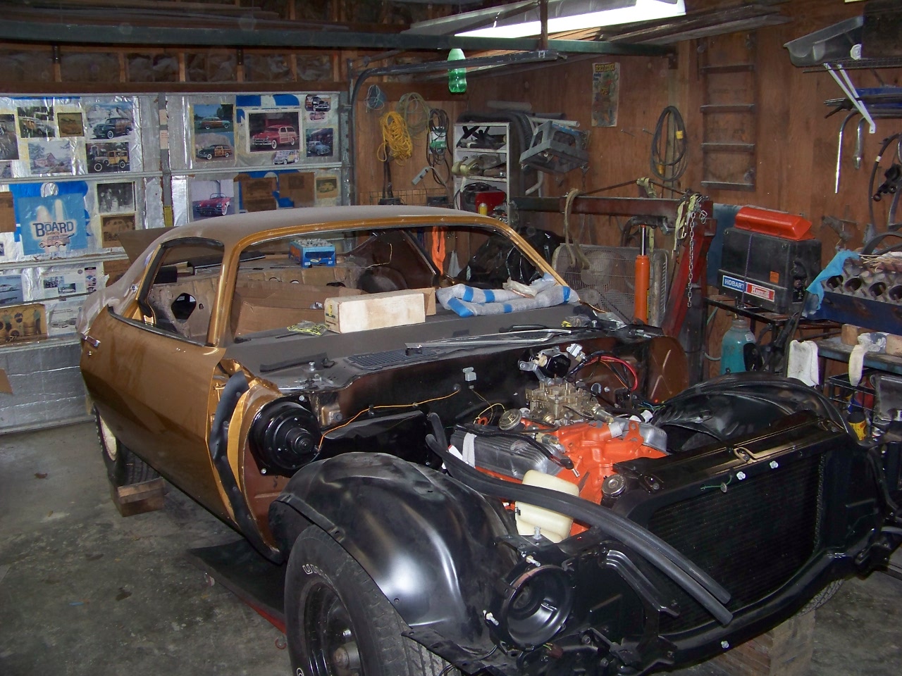

Very nice James.
I should know this, but I don't. Can I put an RC33 radiator cap on my 69 Camaro radiator, run the overflow hose into an expansion tank and have a closed system on my 69? I know it isn't technically correct. Is there something different in the neck that would keep it from working as a closed system?
  #175
Old 12-04-2018, 02:41 PM
firstgenaddict's Avatar
Posts: 5,596
Thanks: 161
Lynn,
I do not believe there is anything different, the cap is incorrect in appearance though, if you want a closer to correct look the RC 26 is a big eared closed system cap.

Installed the fan and shroud as well as the overflow tank...
