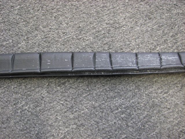

I just purchased as set of NOS drip rail weatherstrips that are badly wrinkled due to being rolled up in a box since 1983/84. Does anyone have a tried and true way to get the wrinkles out? Stretching them does not work. Thanks in advance for any help.

I've used a 250 Watt red heat lamp bulb & Bell shaped fixture with great success. It's worth a try.

The problem is, because the weatherstrip was rolled up in a box the inside diameter is fine and the outside looks fine as long as it is rolled. Once you straighten it out the outside diameter is badly wrinkled and will not pull out due to the inside wire not allowing it to stretch.
The first photo is of them rolled up, perfectly nice. 2nd photo shows how bad they are wrinkled when laying flat but you cannot stretch these due to that wire.

Maybe wave a Hairdryer or Heat gun @ them?
Practice on dead pieces first.
