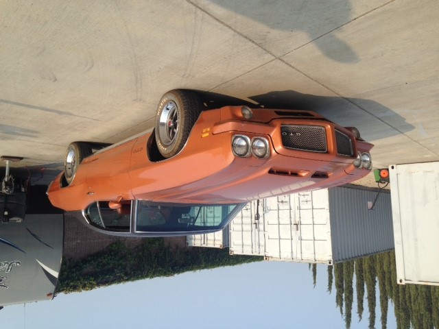

I need to try the same process on this Pontiac GTO we picked up last year.
It has one repaint from the mid 80's, hoping to revive some shine.

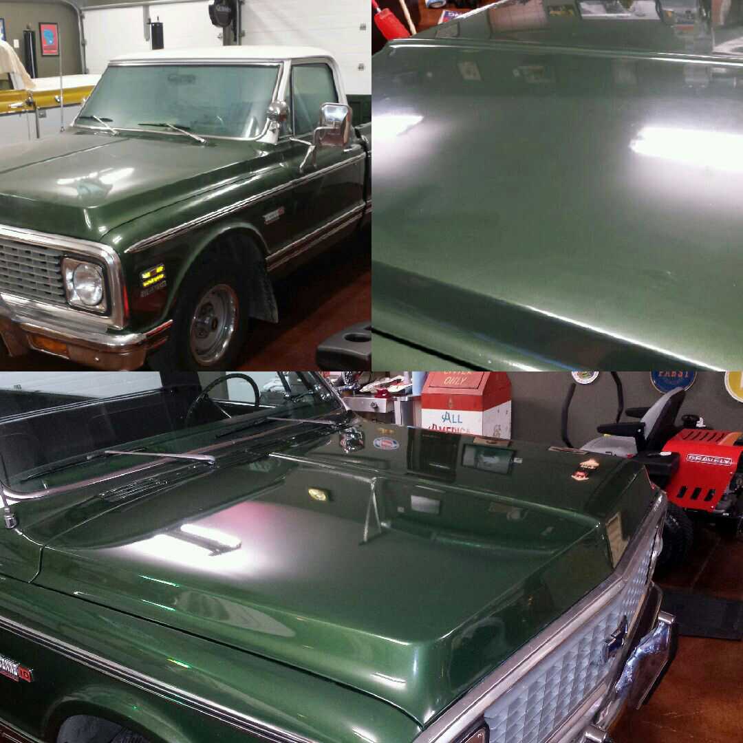

There's no one size fits all with polishing paint, it is definitely an art. On the other end of the Chevy truck spectrum is this green Super with just 43k miles. The paint just needed scratches and swirls removed when I purchased it. The paint had just a light haze over it that can be seen in the first couple photos. If memory serves me, I treated this one to Meguiars 205 & yellow foam pad and topped with Souveran carnuba for that silky, wet look. I'm mentioning all this because your Corvette might just benefit from a light machine polish for defect removal and a topcoat of a quality carnuba wax?

Jerry, your '71 is super sharp! Keep in touch with your progress, I'd love to see your car along the way. I wish we lived closer to eachother, I'd love to check it out in person.
Jeff
