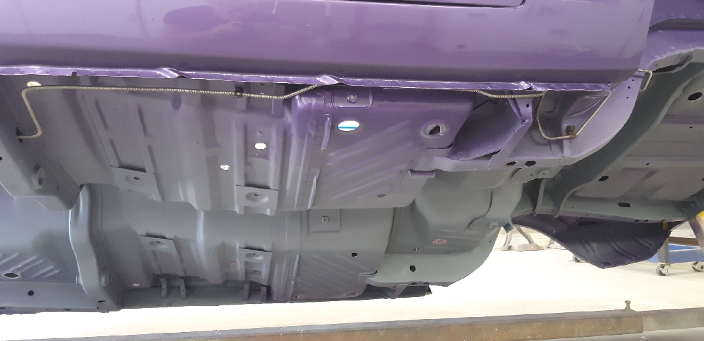

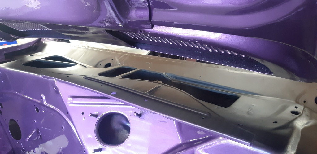

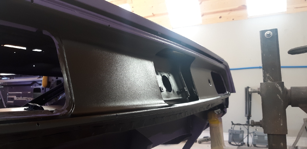

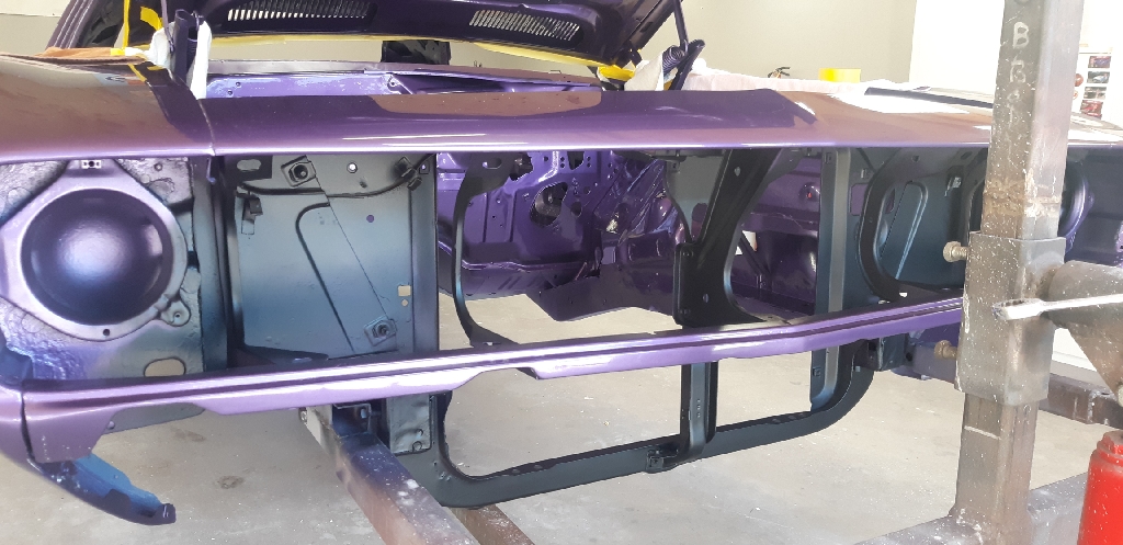

It was a monstrosonous day! No more rotisserie and the Cuda gets relocated to the big shop for assembly! It's a long time coming.... actually... it really wasn't a very long time now that I think about it. But regardless, another major step forward to capitulating Cuda completeness! Here is the radiator support/grille blackout, cowl blackout, and tail panel Organisol (fauxganisol....I used my own technique for it) on the tail panel.
The purps really pops. I'll have to do another round of spot buffing since I missed a few spots, but I'm happy with the results! Before I got it in the lift I installed the brake and fuel lines which are way easy to do with the cat on its side. But honestly, turning a freshly painted car on its side isn't exactly a calming experience. Every creak I heard I thought "Look out! (BAAANG)". Ugh... I've never said this, but sometimes I think I'm getting too old for this!
More to come....
Cheers
Dave

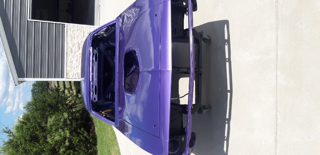

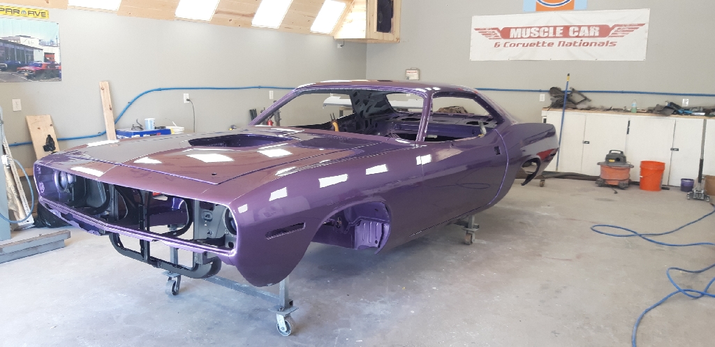

Purps popping in the sun! Really looks good against green trees!
Cheers
Dave

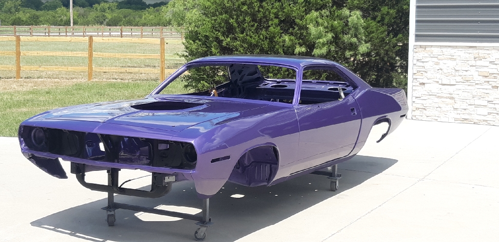

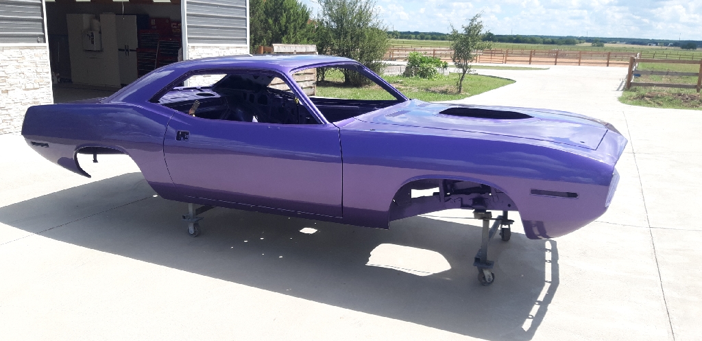

And back onto the lift for reassembly!
Now I can go paint the bumpers!
Cheers
Dave
