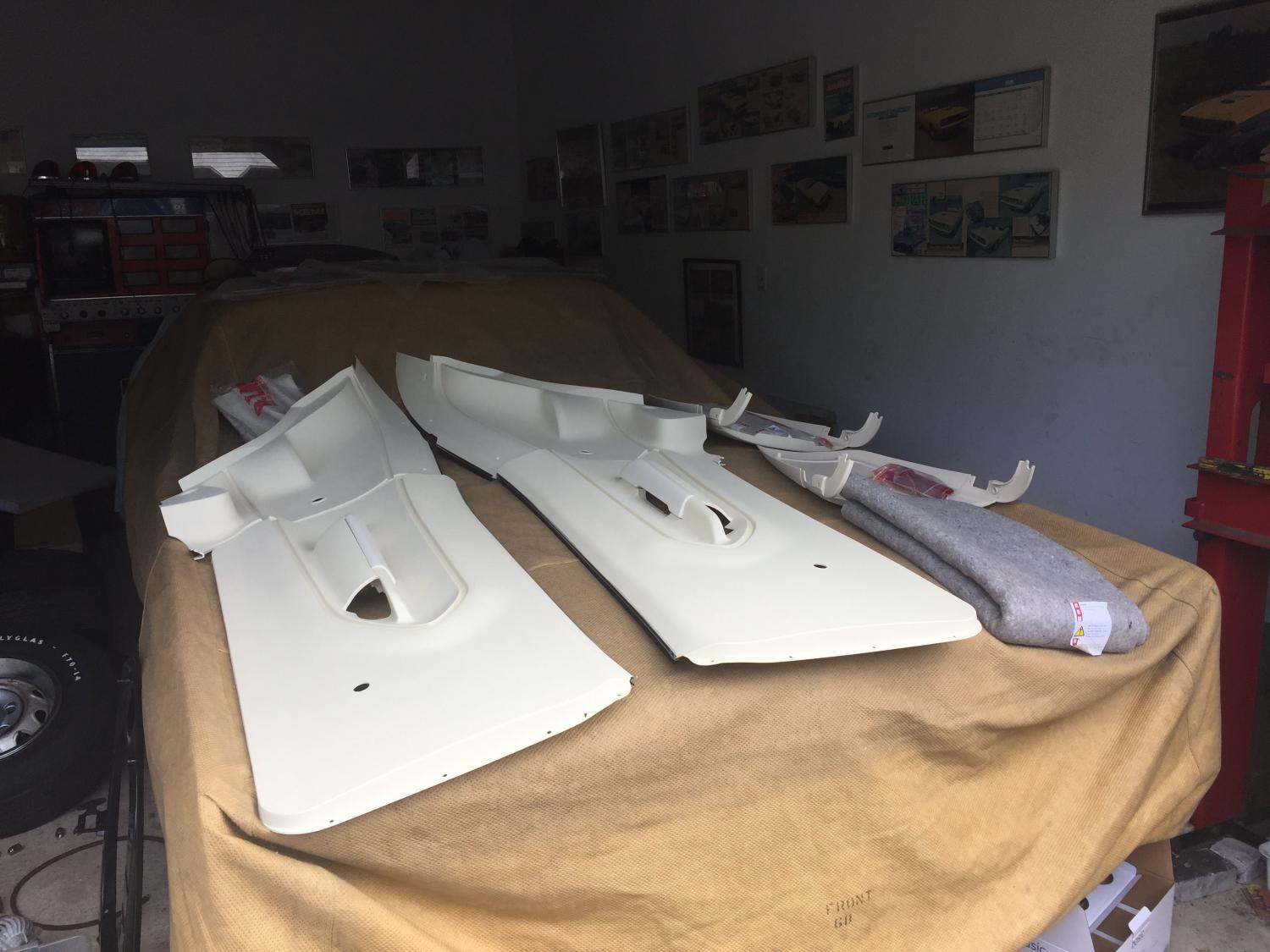

Got the interior parts delivered today after a month or so on order. Unfortunately, they first shipped the $1700 order to someone with the same name as me in another state. I always check my tracking info and I noticed something wasn't right with the destination listed and gave them a call. They immediately contacted UPS and had the shipping cancelled and returned to sender. Once it arrived back, they inspected and reboxed and reshipped to me at the correct address. Everything arrived safely in four giant boxes this afternoon.
Soooo sorry PennsylvaniaSteve, you didn't get a free cuda interior on my dime, this time.
Luckily I have Grampa's Lincoln to lay out all the pieces on.
