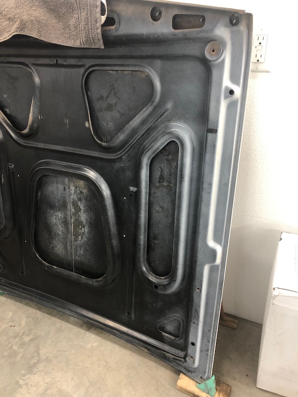

Installed a pair of less than perfect NOS front wheel opening moldings and cleaned and installed the remaining front trim.
I installed a matched set of Sylvania Halogen bulbs, because I had them, it's a driver, and my stash of original T3's is not bottomless.
Like the floor pans, Fremont was generous with overspray body color on the bottom of the hood!!
