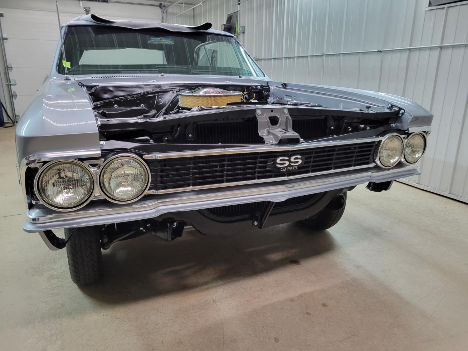

Default Grille and Front End Trim
I also got the Grille back this week from the platter. Alot of taping. This was an original grill so not in perfect condition. I had to fill in some pits in the face area before painting with SEMs trim black. With the redone emblem it came out really nice.

Default Grille Emblem
Grille emblem installed. Glad I had my original or I would have not known there are small black plastic spacers behind the emblem to space it off the grill. Im not sure the repros have these.

Default Front End
I put on most of the front end trim this weekend. All the pieces are originals redone. The only piece that is reproduction and phenomenal quality is the lower valence center piece.
