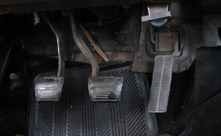

Default '65 El Camino, 283/3-sp OD, Clean CA Truck
Nice '65 - and while it's not a great bargain at the asking price IMO, there's a "make offer" button that should make things more interesting.

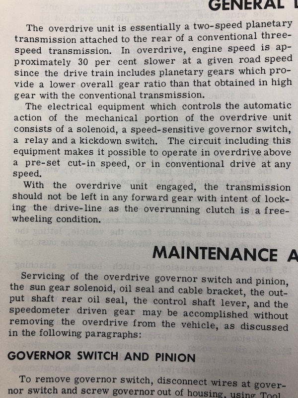

Anybody out there can enlighten on how this "overdrive" functions?

My understanding is the cable actuates a solenoid that engages the gear reduction in the o/d unit. I have seen a few El Caminos over the years with this option. Pretty rare to see one...

Say you are cruising along in 3rd gear... pull the handle out, let off the throttle, it shifts to overdrive. Push the handle in, let off the throttle, it shifts back to straight 1-1 3rd gear. It makes for a sweet interstate cruiser! - Bill W

From the '67 Service Manual...

That is some pretty tricky technology for '65 - way cool
