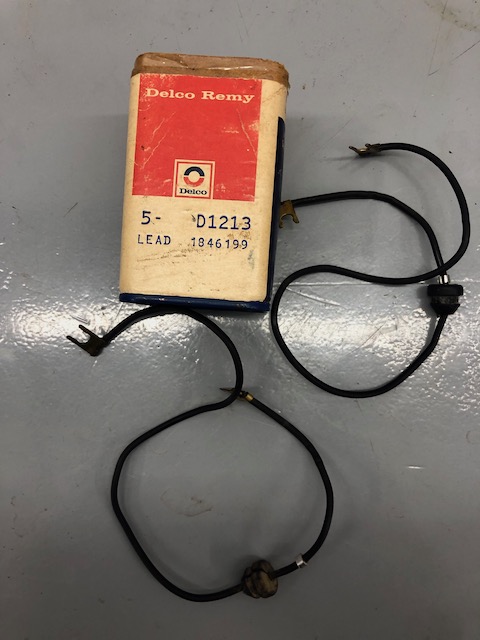

Old 09-17-2023, 04:31 AM
67since67's Avatar
Join Date: Mar 2016
Location: Waterloo Iowa
Posts: 2,091
Thanks: 3,426
A big thanks to my friend Bob Jones (L79 Chevelle) from PA! Bob sent me these NOS leads that he had on his shelf, thanks Bob, I owe you one!! - Bill W
