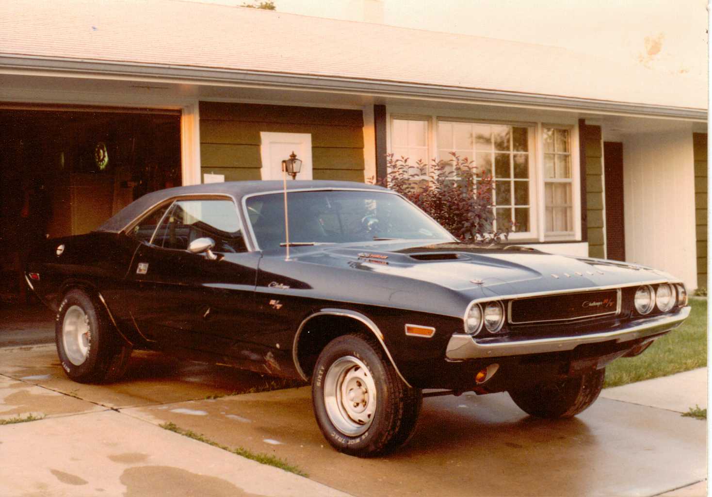

"As purchased" pictures. Note patinaed Grand Spaulding Dodge decal on trunk lid.
Bill Pritchard

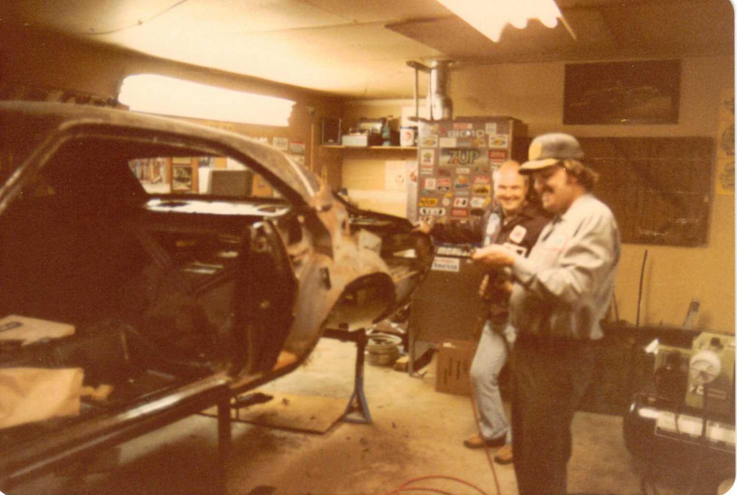

After being stripped to the bare shell, it was time to cut off the quarter panels. I guessed that it would be rusty underneath them, and that proved to be a good guess. This work was done by a couple of my friends, who are pictured here.
Bill Pritchard
