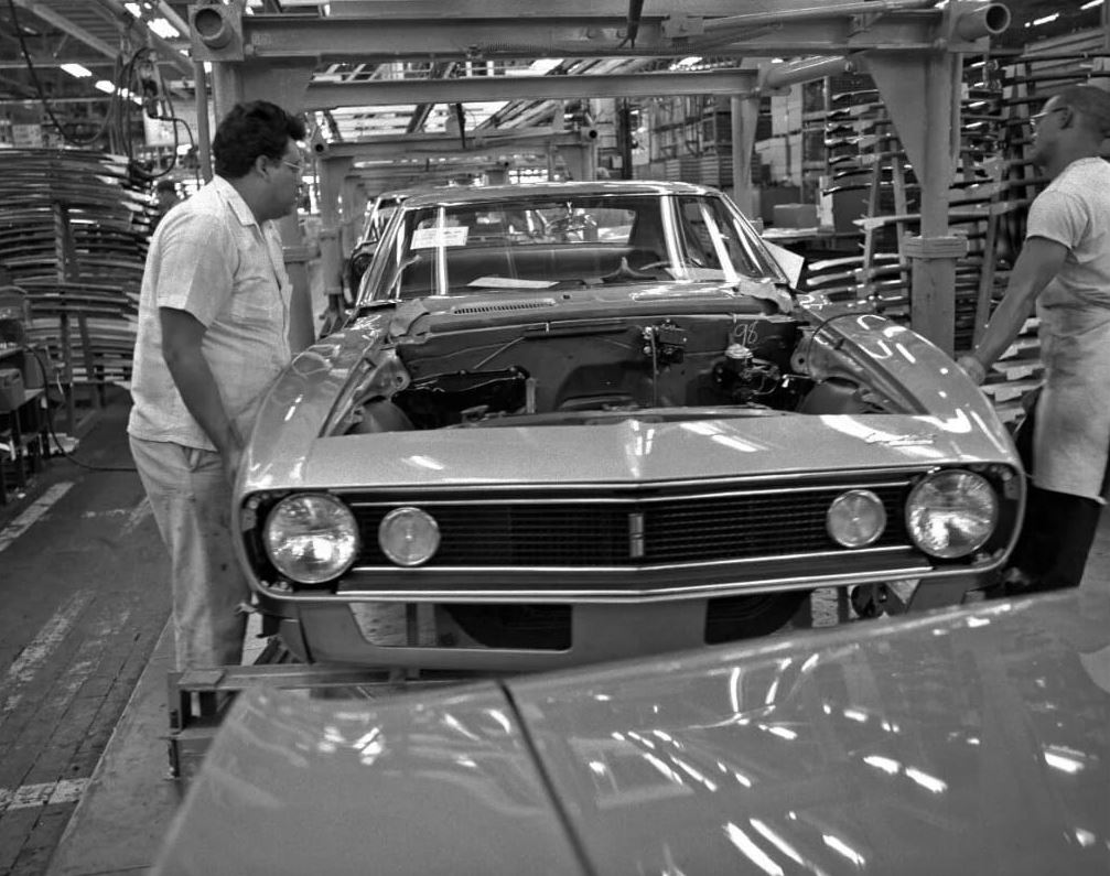

A couple observations here:
1 - see the cars that seem to be going "the wrong way"?
Typically at the end of the final line there is what was called "short line repair". This would be a moving repair line for taking car of small issues that could be handled while the car is still moving (ie, back up lamps don't work, or quick and dirty fitment issues, A/C recharge, etc). For bigger issues the car would be moved to a static stall (aka "Heavy repair") for things like engine R&R, or axle swaps, or frame swaps.
There was typically a similar setup for paint repair: a short moving line for quick and easy stuff, and then a separate are for more major repair up to and including repainting the whole vehicle.
2 - see the flooring. It's those d@mn wood blocks. They were nasty.
They were hardwood, like 4x4 chunks set on end, and coated with something like creosote.
I'm not sure what the motivation for using them was; perhaps because they could be removed easily for assembly line rerouting at model change, or for repairs, or to provide some "cushion" if material (or a vehicle) got dropped.
But they were hard to walk or stand on all day, uneven, slippery, got the sealer all over everything, and made the area dark.
I used to take my shoes off and set them in the truck bed before getting in and wear clean shoes into the house. When I got to work the next day I'd remove my clean shoes, put on my steel toed Redwings and head back in.

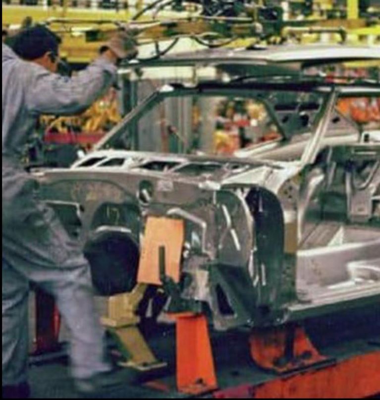

A couple comments about front end sheet metal install -
There were two ways to do this: "piecemeal", that is, one fender at a time, or "buck build", where the fenders and rad support (and sometimes hood) were assembled as a unit off line and brought to the main line already put together.
The two ways would come and go, depending on what was en vogue at the time or who was in charge and what their favorite was.
When I started at Flint Assembly in 1979 it had two separate lines: Line 1 was full size pickups, at 60 jobs per hour, and Line 2 was Blazer/Suburban, at 36 jobs per hour.
Line 1 fenders were installed piecemeal (an area I actually supervised as my first "real job") and Line 2 front ends were buck built.
Same product, same building, two different techniques under the same roof.

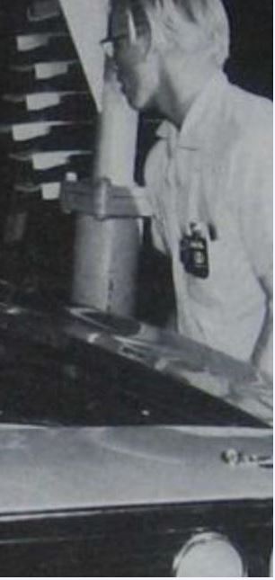

You can see the build sheet hanging here, telling the operator(s) which parts to put on.
People like to talk about "finding THE build sheet" (which is remarkable, no doubt) but there wasn't just ONE build sheet: there would have been several.
Any area where parts were built up remotely and then conveyed to the main line would have had it's own build sheet: front end sheet metal, motor line, chassis line, seat room, axle line, etc.
The build sheets were supposed to be gathered up and thrown away along with all the other debris in the vehicle (extra screws, paper cups, love notes, numbers lists for your bookie, inspection tickets) but sometimes they got built right into the vehicle (in the seats, or behind the headliner, or under the carpet, or in the doors, or on top of the fuel tank) and it was easier to just leave them where they lay, sometimes embedded in goo or with a screw shot through them.
It must be a pretty good system; 60 years later we still build vehicles with a piece of paper hanging off the front end.
Speaking of inspection tickets - they had an additional informal function beyond just tracking repairs and completion. The tickets could indicate, based on where they were placed, what repairs were required. That is, rolled up and placed inside the coils near the master cylinder could indicate that the brakes failed the pressure test and needed a repair or to be re-bled. Smashed in the door opening might mean one thing, under the windshield wiper something else, and coiled and placed in the door handle yet a third thing.
Pity the poor young engineering student who pulls the ticket to look at it and then puts it back in the wrong spot.

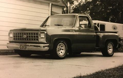

At Flint, we had 1/2 ton 2wd (5 lug axles), 1/2 4wd (6 lug axles) and 3/4 and 1 ton axles (8 lugs). We used to keep a library of "wrong" tire/wheel assemblies at the tire install job so that if you had a wrong axle come down you could install the corresponding "wrong" tire/wheel assembly in order to keep the line moving. The vehicle would complete the process and then head out back to heavy repair to have the correct axle (and tire/wheels) installed.
Back to the sequence number - my red truck was apparently "number 87".

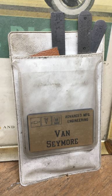

You guys remember “pocket protectors”?
I don’t think I have any of mine, but I do have this one of dad’s on display.
Part of our daily arsenal, including these VIN cards we carried everywhere (for some reason; I guess in case we had to de-code a nasty VIN while we were in the bathroom or something) and a folded piece of paper with our notes for the day. Our nerd uniform would not be complete without it.
Also – the shirts for the foremen were provided by GM. Available in the lovely pastels of the time (coral, blue, green, yellow) and, of course, white, they were emblazoned with the person’s name and the Chevrolet bowtie.
I used to wear dad’s to school. I thought I was so cool.
