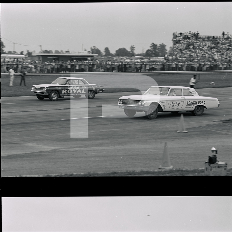

Those are not easy cars to build so there’s not many of them out there. I remember when the Green car was advertised several years ago and I’ve always been suspicious if it was the missing Royal 421 transplant FX car.

Oh my.
The green car got painted black and supposedly is in CA.
