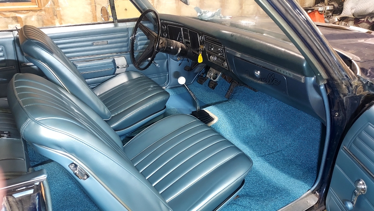

I'm a long-time lurker here, and finally signed up to share this Day 2 Chevelle I bought last summer. Previous owner bought it in 1974, and last drove it about 1985. He passed away recently, and I bought it from his brother.
68 SS396 Fathom Blue/Medium Teal
Originally bench seat 4spd, now has buckets.
Engine in it was an L78 out of a 69 Nova, JH suffix.
Trans is a numbers-matching M20, and has KF (3.55 posi) 12-bolt.
1111169 Distributor in the trunk likely original to the car as well.
It has some cool period speed stuff on it, such as Mr. Gasket Vertigate, traction bars, Steel bellhousing, a Fly Eye air cleaner (was in the trunk and warped from being burnt), L60-15s on 15x8 Corvette ralleys, Headers, Thrush glasspacks, etc.
