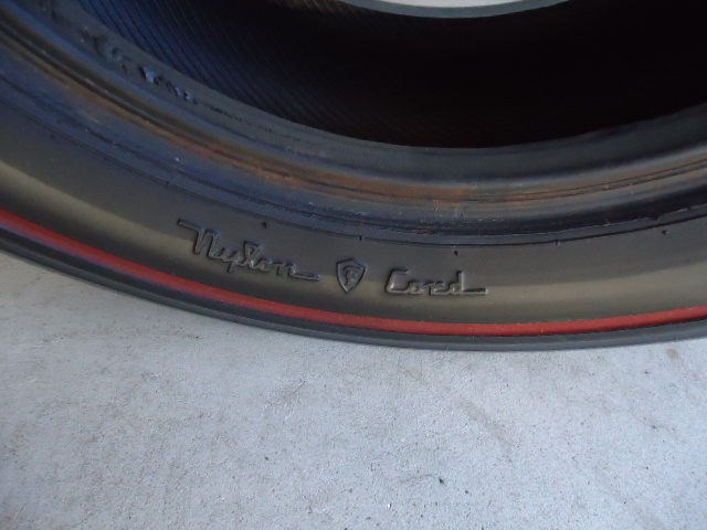

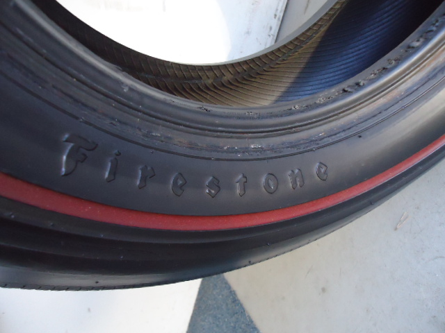

My apology Mike,I was wrong when I said yours is 100% a reproduction tire.I now believe you have a real 50+ year old RWL tire there.
When I said tread design,I was comparing yours to this original redline Firestone tire I've had in storage that shows 8 tread valleys.I always thought it was an original Firestone F70-14 RWL up there,but could only see it's tread design and nothing else.Untill I removed it this weekend and see now it's really an F70-15 Firestone Bias-ply Redline tire,not a 14" RWL at all.
Sorry about that,and you have a very nice find that I wouldn't mind owning.

Interesting info Jeff,so my FS Redline was molded after June 1967,up till about Feb. 1968?
Here's a few more pics..(Sorry to steal your topic Mike)

Yours has the stacked Wide O Oval (older style), AND Nylon Cord (second style). So that might be yet another step in between two of the styles that I described, that I have not yet seen on a 14" tire.
Or maybe the 15" sidewall had a little more room for them to play with on the stripe so they didn't have to unstack Wide O Oval to move the stripe in farther ?? I must admit to not paying as close attention to 15" tires as I have to the 14's, since all my cars came with 14's.

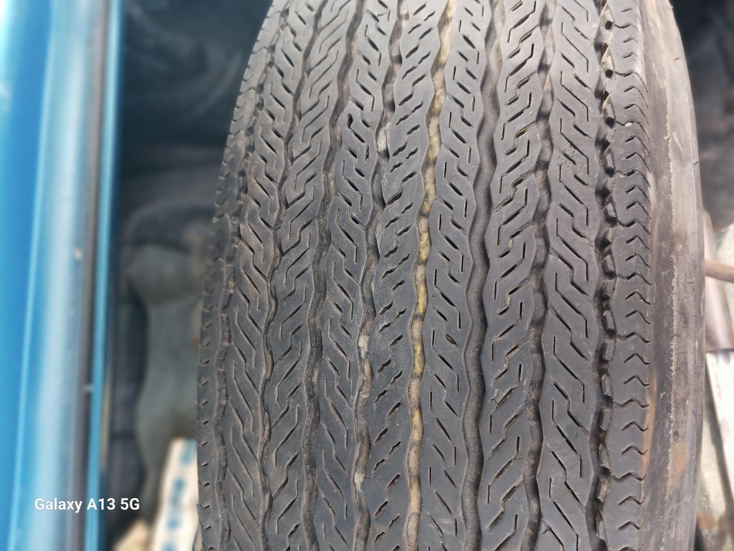

Default 69 firestone F70x14
Late to the party also.
Pic 1- 3 is the spare tire from her 2C 69 Baltimore SS Chevelle.
All 5 wheels have same date 1 6 9.
Pic 4- 5 is the spare in a different 69 Chevelle that still has the ink on it.
