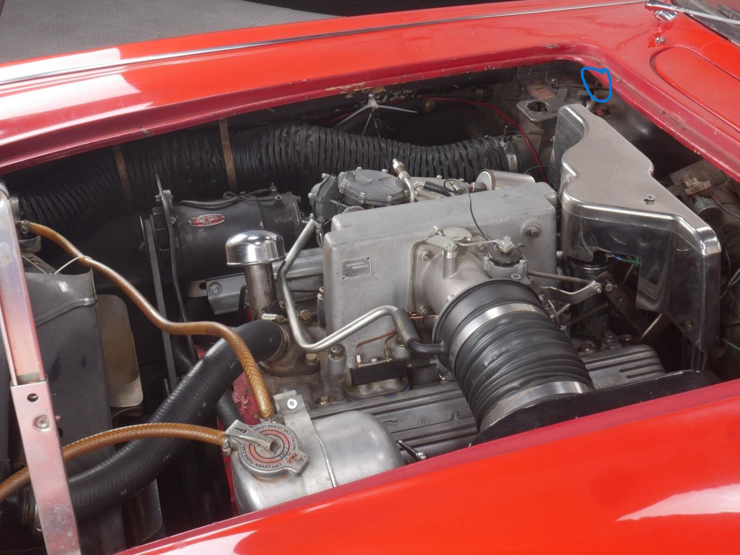

Another 'information to be added' auction description, but an interesting car nonetheless. Seems like a potentially decent deal if it's in fact an original Fuel car with its original mill.

Hard to tell is it's an original fuel car. By the pics offered, there is one "hint" that it could be. The rest of the pics are inconclusive.
In the upper right of the engine compartment, the hoses for the windshield washers would come through the firewall in the location circled. This was due to the washer bottle being on the passenger side for F.I. cars. All carb cars had it on the drivers side.

Thanks, Tim - great info.
