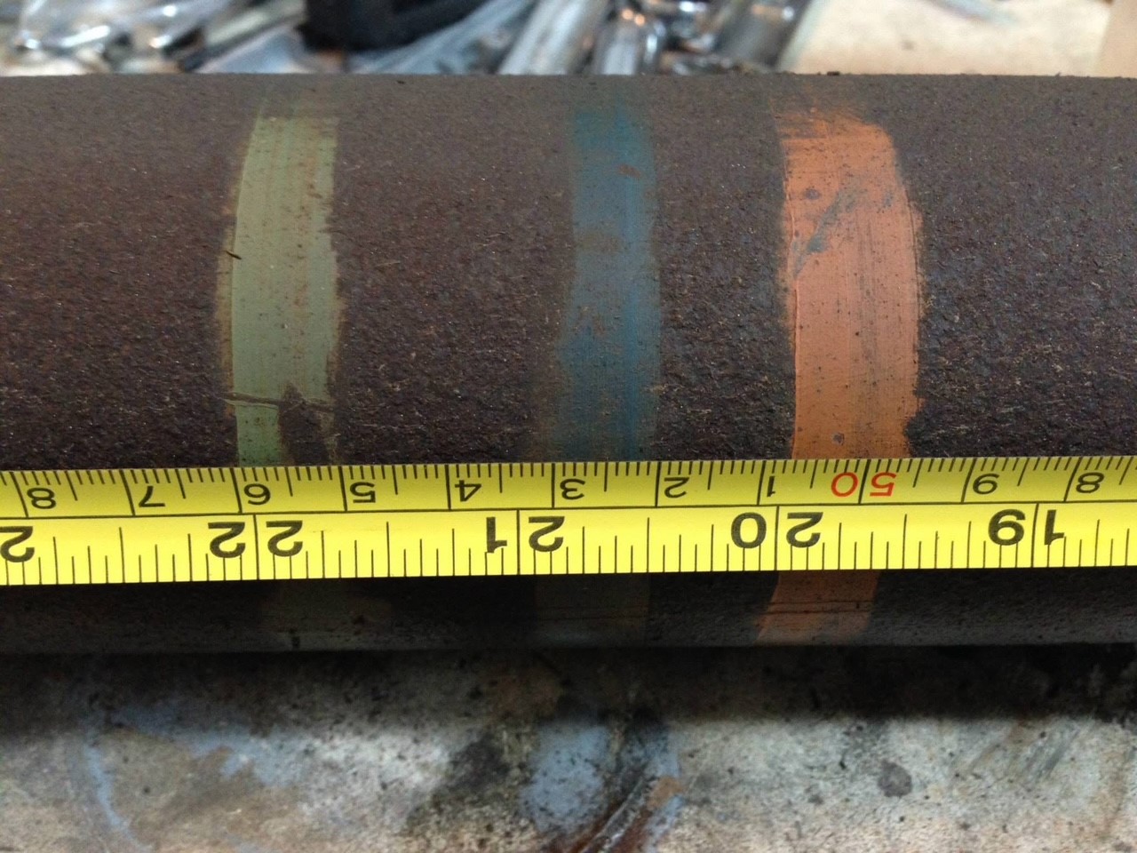

I'd be on hunt for a L78
Id still be interested in finding a documented 68-70 L78 4 speed.

Originally Posted by 69W314spd View Post
My question is about the driveshaft stripe color, i believe that the drive shaft is original to the car and has what i believe to be an orange, blue and white stripe and was curious of what this could mean as i dont have build sheet.
I have been looking at 3rd Gen Nova driveshaft stripes for a while. There are not enough examples to give a definitive conclusion. There are several known stripe patterns.
In 1968 there are seven driveshaft service part numbers and three yoke types with multiple part numbers.
In 1969 there are three driveshaft service part numbers and three yoke types.
In 1970 there are the three 1969 driveshaft service part numbers plus one new one for 1970 plus the three yoke types.
On this site there are reports of three 1969 L78 T. H. 400 (M40) driveshaft combinations. Does this mean there are multiple 4 speed stripe patterns?
The sparse number of broadcast sheets doesn't help.
In theory is there are five driveshaft / yoke combinations:
Nova (exc. T.H. 400) w/3-Spd, P.G., 4-Spd Non SS
Nova (exc. T.H. 400) w/T.H. 350 Non SS
Nova w/2-Dr. (T.H. 350), w/4BC (350)
Nova w/4-Spd. (350, 396) w/special 3-Spd, SS w/4Spd
Nova w/T.H. 400 (396)
None of this helps with the question without more examples.
In 1969 the 4 Speed had an early and late version. Your 69 Nova is late according to the VIN. I would just put back what you found. What you see as white could be pink or tan.
Greg
Nova Research Project at chevynova.org

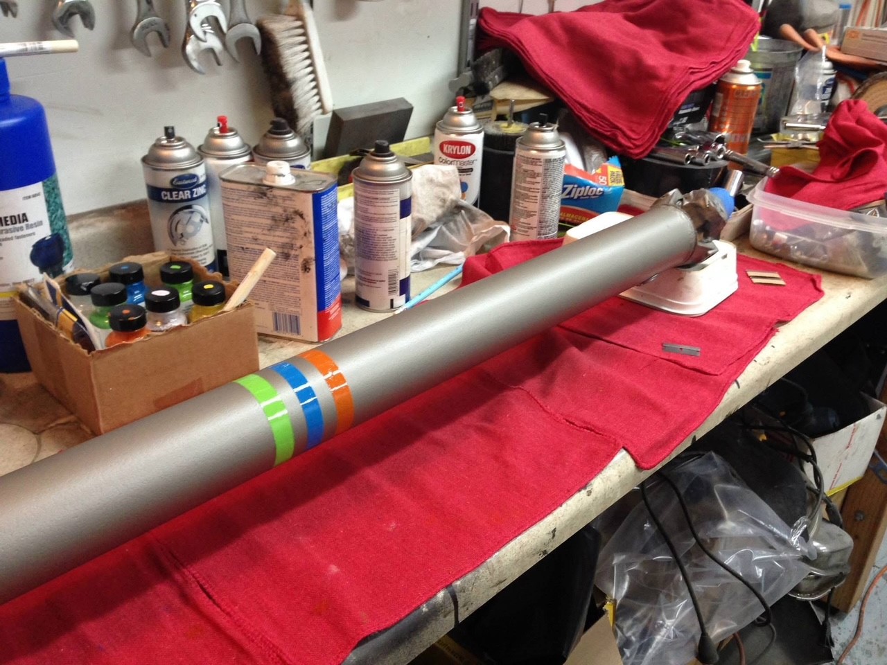

for what its worth, here is the original driveline in my documented 24,000 mile '69 L78/M40 Nova before and after I restored it.
Cool Nova! Love the Cortez Silver!
Paul
