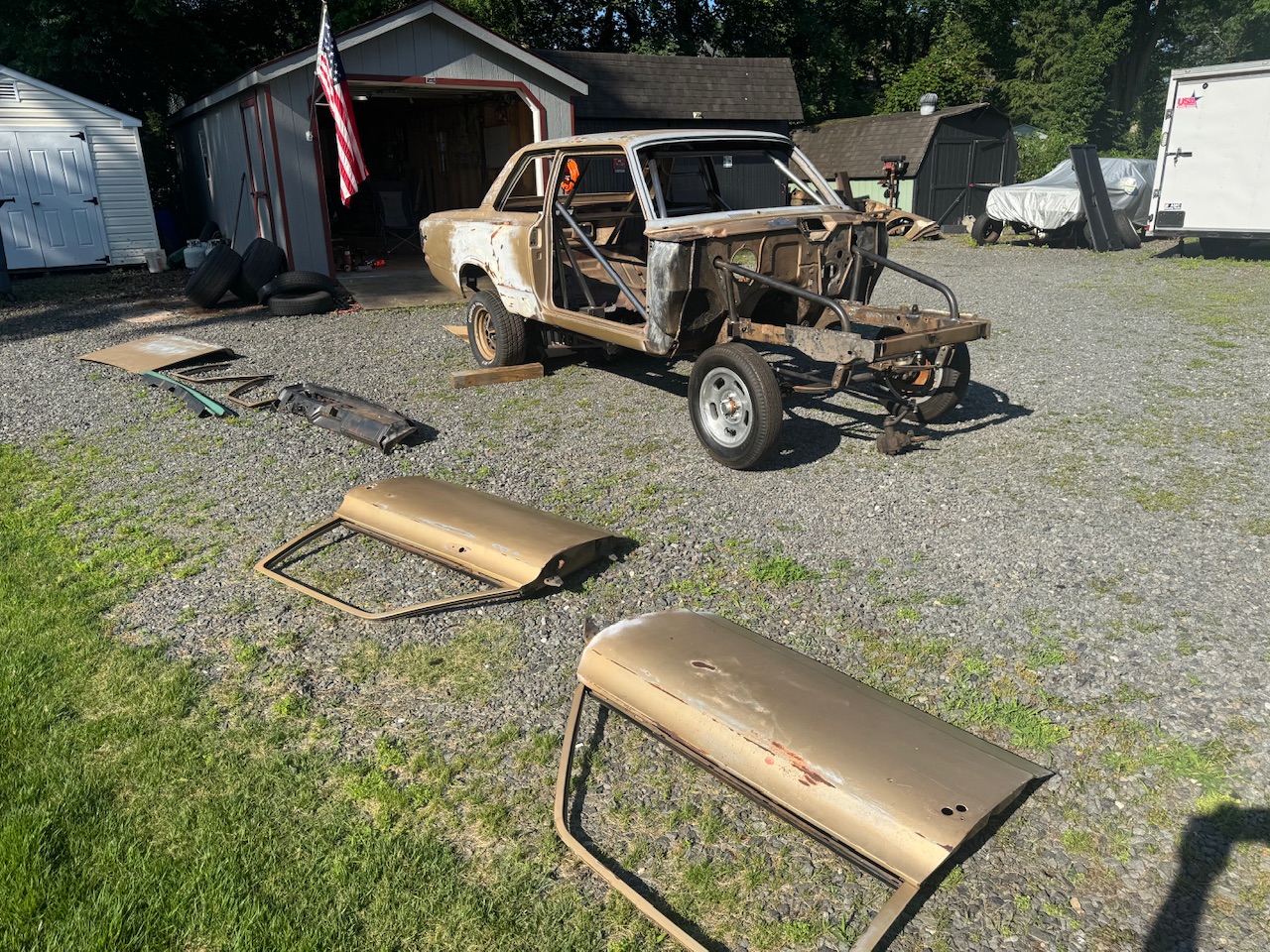

I was going to post an update where I was very excited. All day today was spent getting the car media blasted. Top and bottom. Mostly because I wanted to remove all the factory undercoating and I figured since I’m keeping this car for the long haul I’d get the topside blasted to have all fresh metal to start with.
I guess that ended up being a mistake because everything is warped now. It wasn’t noticeable until a couple hours later and everything was out of the sun and cooled off, but the roof, nice original trunklid, doors, and quarters to the gasser are all warped. I guess I should’ve known everything was going too well.
I’m sure it all can be fixed and I’m trying really hard not to be incredibly disappointed about everything being damaged. I spent good money with a guy who swore he’s had experience blasting cars and wasn’t worried about it. I’ll probably have an update once the car is in epoxy primer and I can start figuring out where to begin with the mountain of bodywork I just created for myself.

I was hoping, for your sake, that wouldn't happen, but it is all too often the outcome. Pulling warped sheetmetal back close enough to not need a ton of filler is an art unto itself. You may be able to learn how, but things will get worse during the learning curve.....been there and still learning...sorry for what you had done.
