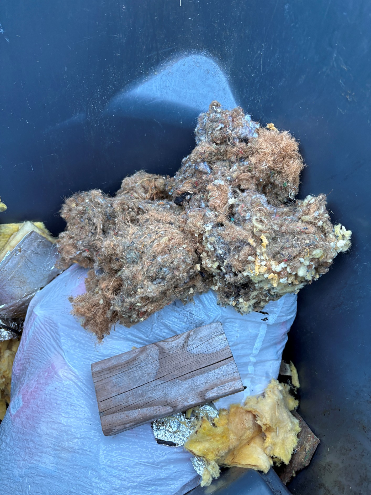

And...the mission creep continues. When I got home yesterday I decided to pull the interior for a deep cleaning that has never been done. And I did have one young kid stick their head in the car at the show and say to their dad "This car smells like old people". LOL
Due to all the years of storage it has had its battles with mice, mildew and mold. I pulled everything out and started cleaning. Found two enormous mouse nests in the back seat and several petrified mouse mummies under the carpet.

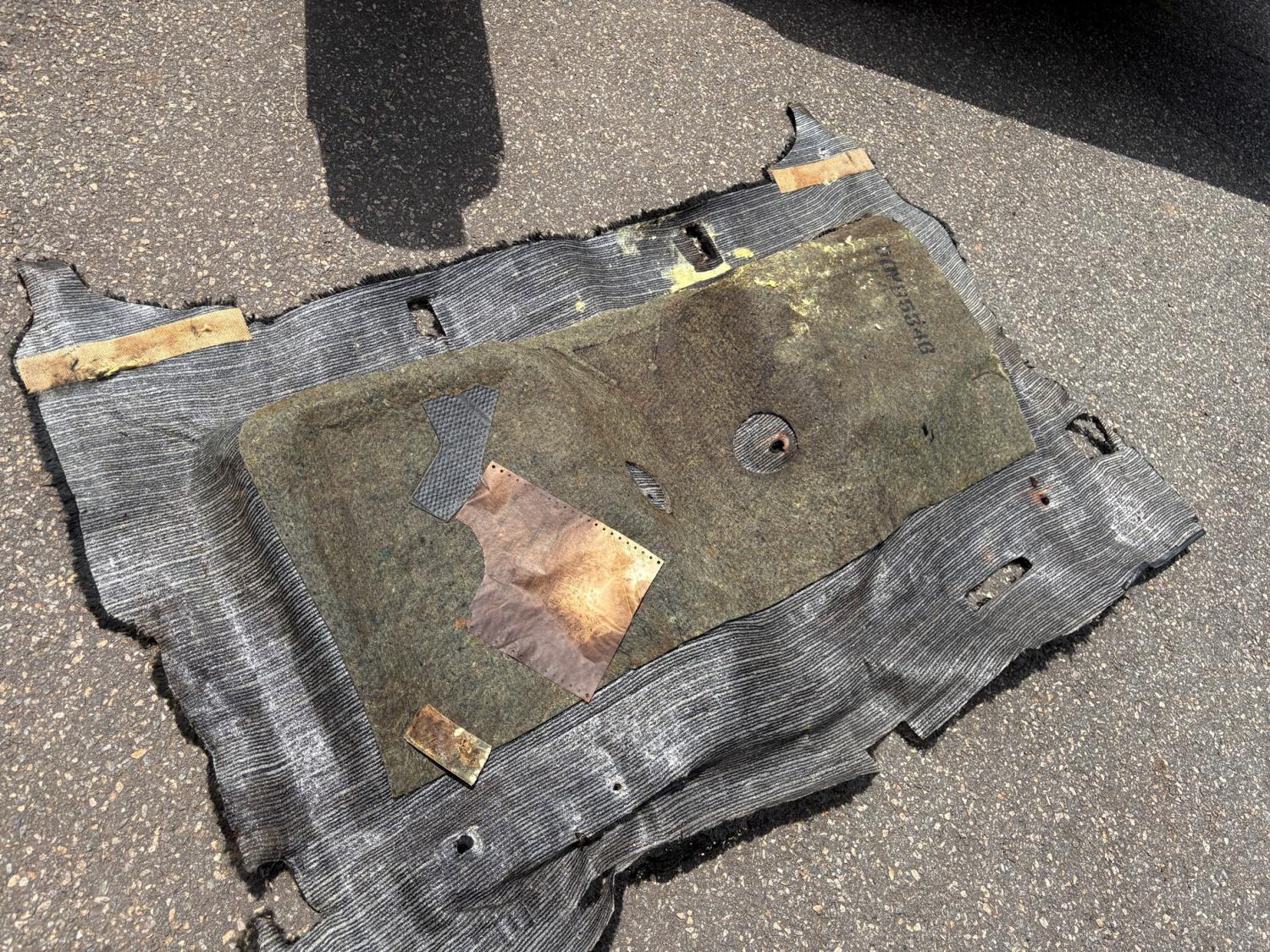

Thanked 2,672 Times in 829 Posts
Found several broadcast sheets including one that said "REWORKED DOORS" on it. I am borrowing the wife's carpet cleaner today to shampoo the carpets after I spent an hour vacuuming them out and beating them with a stick to get all the sand out. And the mouse nests (next to a piece of 2x4 for scale).
