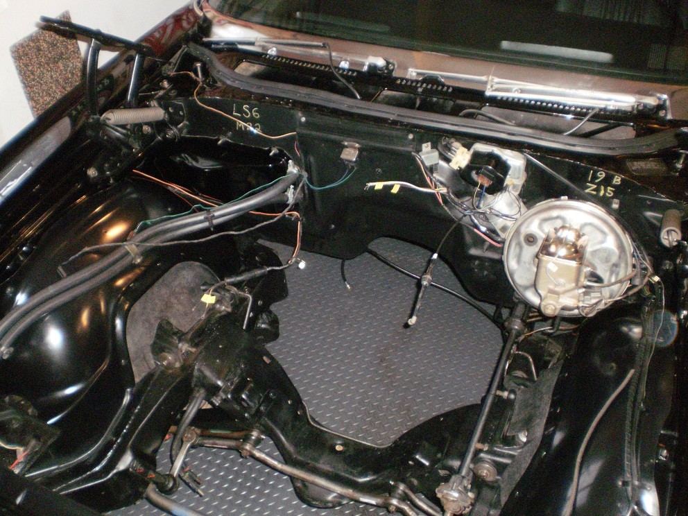

First Off is the Engine bay without the Motor.
If you spot anything that does not jive, let me know.
The Brake booster has never been off the car so it stays as a survivor part with it's faded silver color (i know it should be Gold Cad plated).
The Windshield Washer Motor also seems to be a survivor so i will also leave that alone.
Wires just needed a good clean up and there were no splits or rewired pieces to be found (only had to ad a new wiring connection for the -Negative wire for the Tach Brown wire that goes to the coil as the other Connection plug was hooked up for the former HEI ignition system.
Original Brake lines were polished with a wire brush and then sprayed with Krown T40 protection.

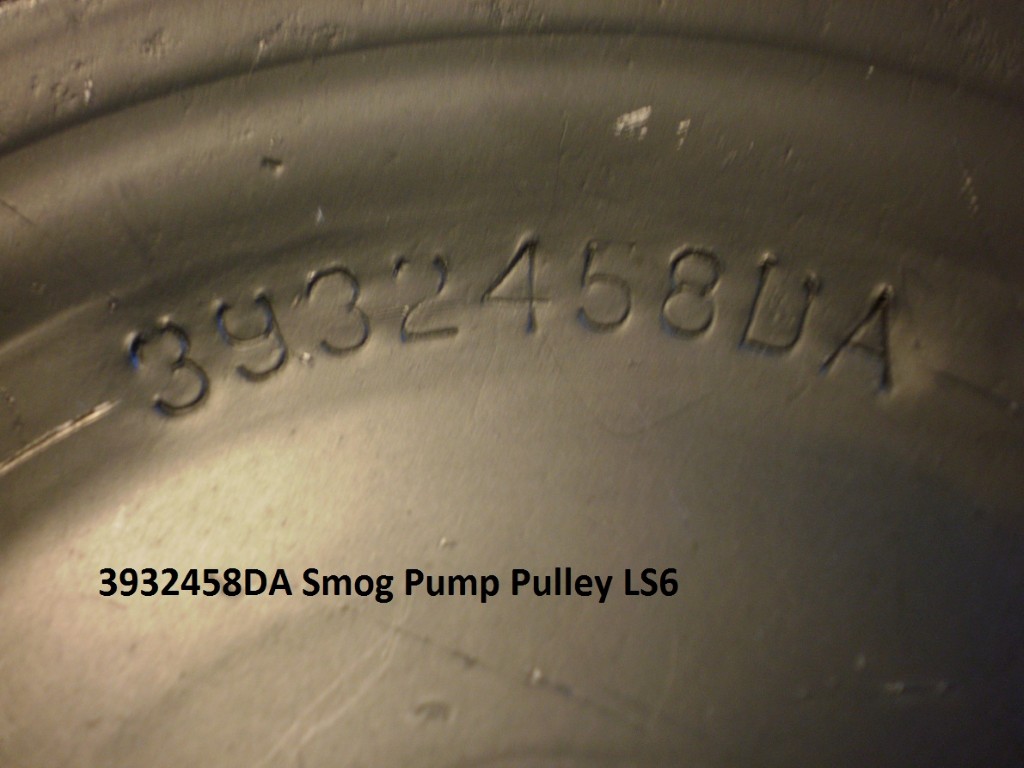

Here is the Smog Pulley

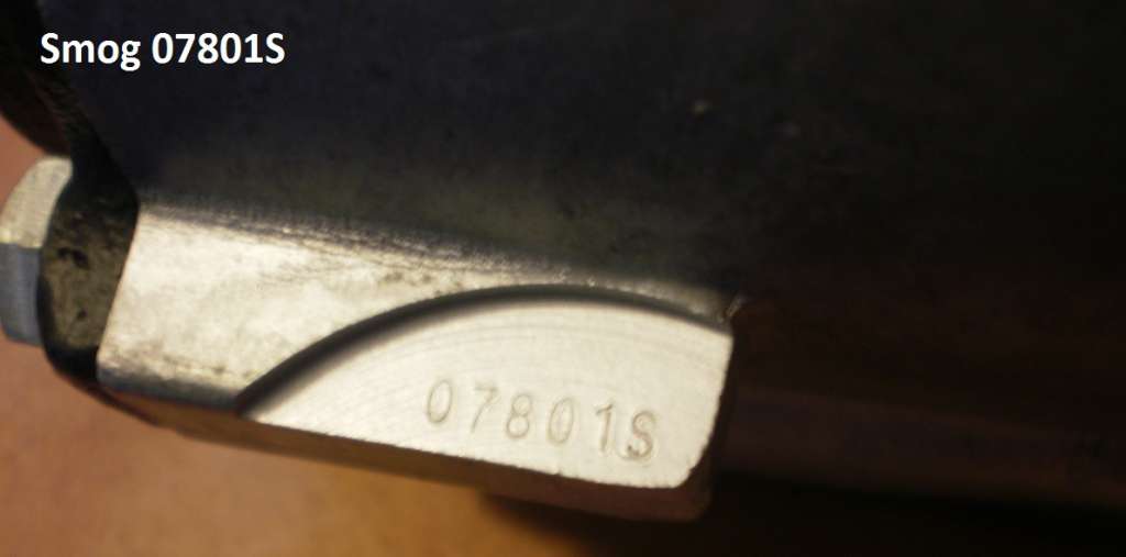

Do you need a white SMOG fan?
Your SMOG Pump shows an assembly date of March 19th,1970.
I know you said you have an April 23rd car,but what's your engines' assembly date?

<div class="ubbcode-block"><div class="ubbcode-header">Originally Posted By: Mr70</div><div class="ubbcode-body">Do you need a white SMOG fan?
I know you said you have an April 23rd car,but what's your engines' assembly date? </div></div>
The Fan is white underneath the Pulley, Is that the fan you are talking about? if so i do not need it.
Can you tell me were you got the March 19th date From the smog?
(Which Photo)
Engine assembly date is March 26 On the front of the block and March 5 Casting at the rear of the block.
Old 11-29-2011, 03:07 AM
Posts: 20,896
Default Re: 1970 Chevelle SS 454 LS6 Rebuild + Details
Yeah..that's the fan.
March 19th comes from your 07801S code on the machined pad.
