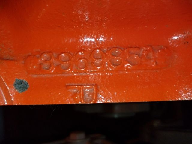

thanks Jason..that means i'll never see the dates..they are bolted on a 427 and i will never see them..this week he will pull the valve covers and shoot a pic of the part numbers *edit* HE SENT ME A PIC AND THEY ARE 842s
well i got pics of everything..i have questions..
its an early motor or at least i think it is..i'm no BBC guy..it has a 163 intake...and i thought all 70s had the flat 3963569 intake...or was there a change over period?? ..i just dont i know..the intake is in the date range to be "date correct" and thats confusing to me..anyway..i want to look around and digest what i found out today.....but good or bad..real or not i will post some pics...
theres no definitive proof the original car it came from still survives..its been in a 70 SS car for a long time..was freshened and was removed for a wicked 572 crate motor..the deal all came together because my buddy wanted the alum heads....and the deal just worked out for both guys...more tomorrow

No change over period.All 1970 BB solids did have the #569 intake..Someone removed it and installed a #163 later on.
I would STRONGLY suggest you trying to obtain those early 1970 dated #842 heads if this engine block is indeed from that block & from a 1970 L89 Nova.
Their dates are key.

will never happen..i will never get the heads..ever
here we go..until i figure out if the car is still in existence i wiped out the last of VIN and water marked them...and i do have a a line of ownership on the motor 3 people back now, so i will start working on it...but i fear its going to be a dead end..
SO WHAT DO THE EXPERTS THINK..AUTHENTIC STAMPS?..

Wow. Pretty cool. The W in the VIN stamp looks a little off to me, but I'm not a Nova expert by any means.

Wow, Looks good. Never say never on the heads.

I'm not an expert but I don't like it.
