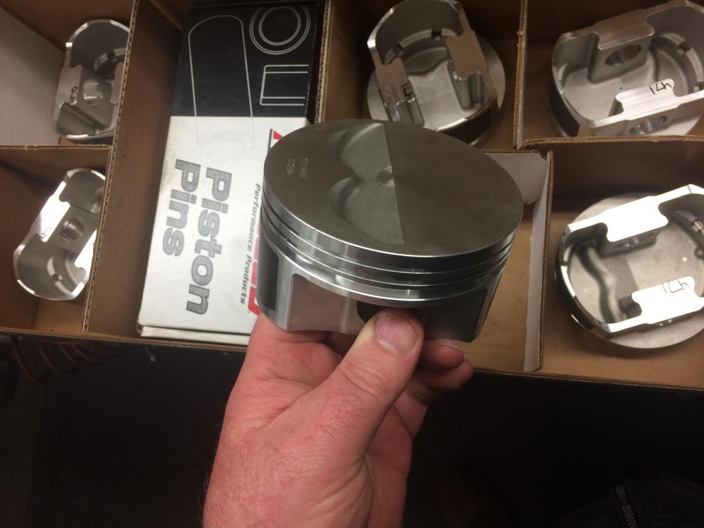

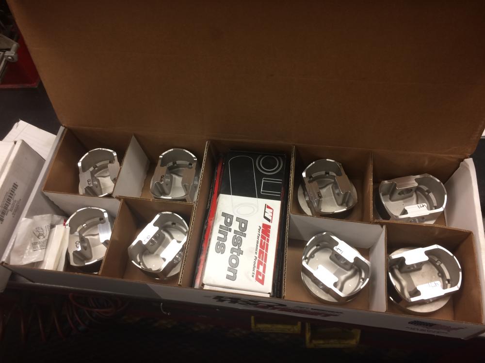

Forged Pistons:-) floating pins and spiral locks:-)
Wiseco ProTru.
PSMCDR allows 0.070" overbore and these are 0.068" over:-) my 350 is now a 362:-) allowable max compression for the W31 is 12.0 to 1, I am only going 10.0 to 1. Maybe someday I would consider getting competitive? I need a little experience before getting sucked into the uber drag race vortex!!!
