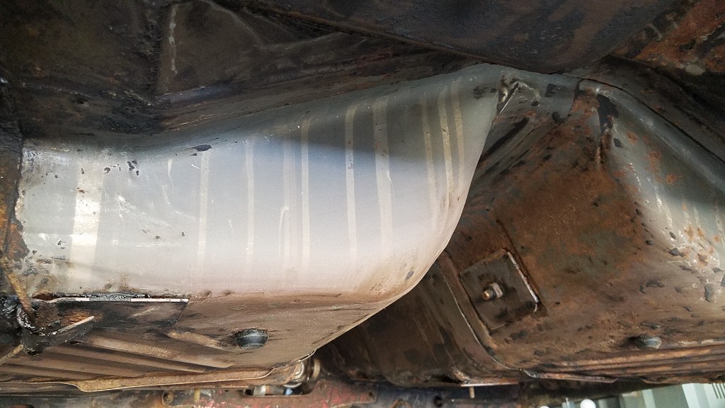

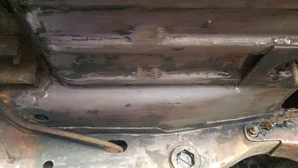

Well, I can't leave well enough alone, so I decided to hold an "Undercoating Removal " party and invited all my friends! Strangely, nobody showed up. I'm not sure if its because people hate to remove undercoating, or despite my idea of myself...I really don't have any friends. But, just like my entire high school tenure, I didn't let that bother me.
Crusty being an undercoated car really helped save those floors. Luckily, no rot despite their rather crappy appearance. I mainly wanted to start documenting all of the factory overspray pattern from the rocker panels inward, as well as the dip gray primer. Under the driver's side, a sample of just about as mint as you can get 1970 FC7 In Violet!

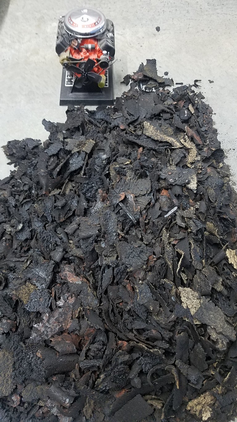

I swept all that mass into a pile that was yyyeeeewge! So big in fact that for comparison and scale, I positioned a 426 Hemi I had laying around next to it, then got the ladder out to take an aerial shot. I'm telling ya! Yyyyyeeewwge!
Ok... maybe it's not that big, but it'll be doubley that big (doubley??) after I get into the wheel wells and rear floor transition panel.

Dave did you just warm it up? My 300G looks like someone drove down a fresh asphalt road it is so bad underneath. I was thinking about trying that flooring removal material you can get it Sherwin-Williams

Bill, yes. Hand held propane torch and a paint scraper. In some areas...a plastic scraper where it was easy to remove to prevent gouging. Brake cleaner afterwards gets rid of the remaining residue.
