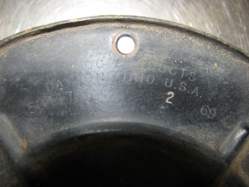

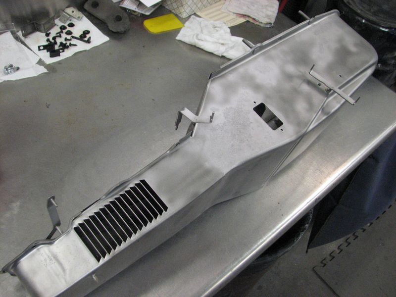

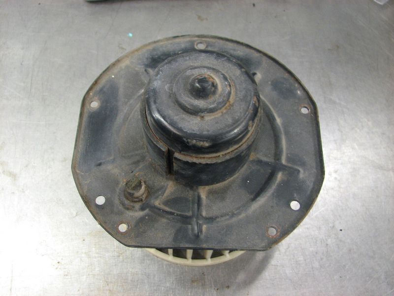

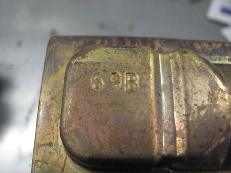

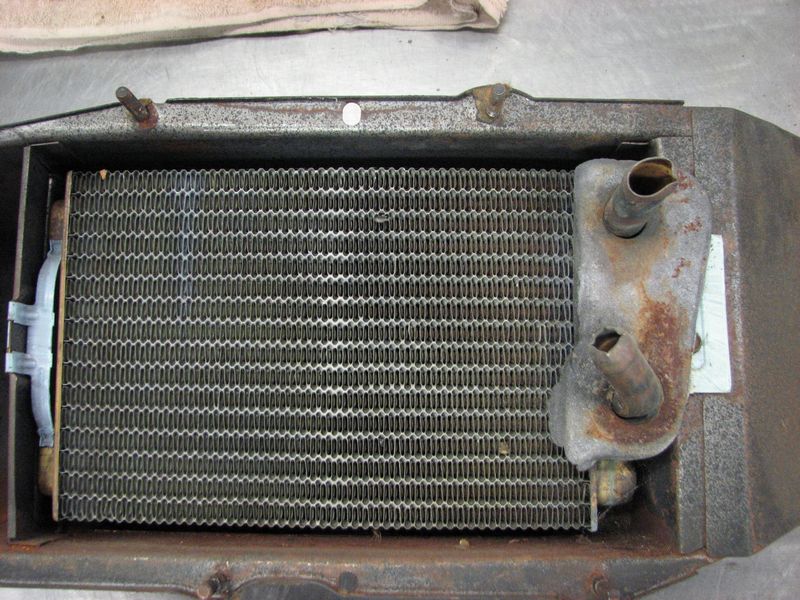

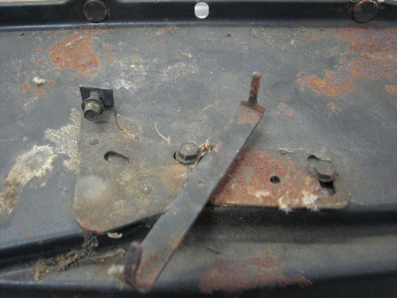

Next came the interior heater box. What appeared to be a very rough box actually blasted up quite nicely with a minimal amount of bodywork. Next we plated the brackets or brought them back to their natural finish depending on the bracket, painted the housing, applied new foam to the vent door, painted and reassembled it. The 982 was added only because I almost always see a number grease penciled there and it always matches the one that is hand written on the top left corner of the buildsheet. This is the same number we found on the fuel tank. We hope to retain the original 69B dated heater core as well.
Hopefully people look at these photos and understand why quotes to restore these can be expensive as they are very time consuming (to do them right).
Rick Nelson

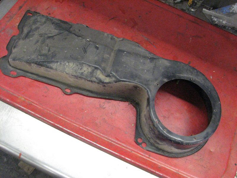

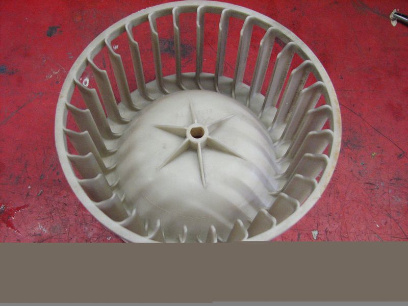

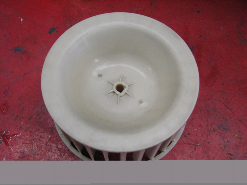

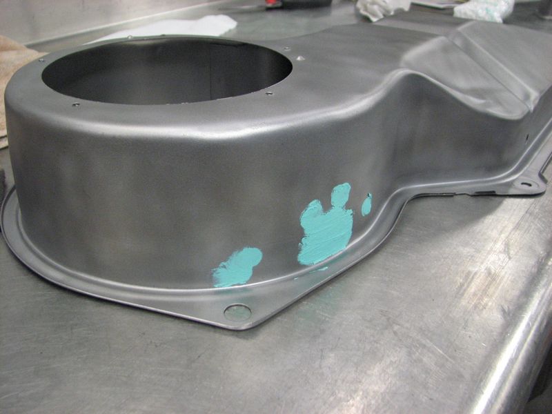

Next was the outer heater box. Fairly straight forward as all that was required was blasting, minor body work, cleaning, prime and paint. The bird cage was glass media blasted. I have found that more often then not these heater core covers were dipped in lacquer. Since this is too large to dip I have to spray them and use a fairly high gloss same as the factory. The heater motor (original dated one) was stripped and painted semi gloss black using new dull zinc bolts to attach it. I have found the sealer to usually be grey in color even though it looks black from staining so we now always replace these with grey sealer.
The heater control was in pretty bad shape and required a full restoration (we do that on every car anyway) so this took some time but well worth the efforts.
Rick Nelson

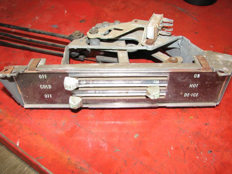

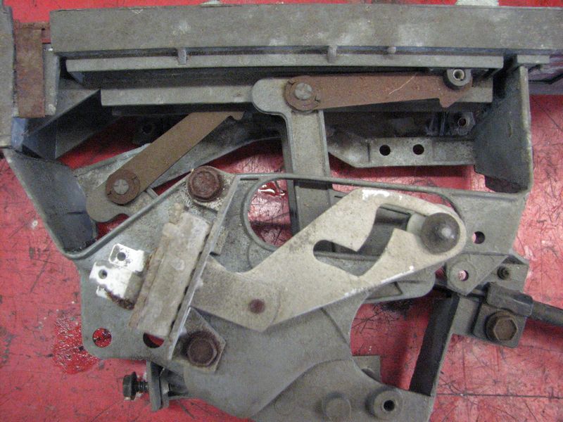

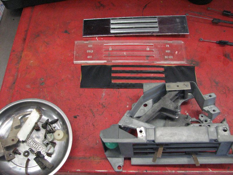

The last part of the puzzle was the heater control. This can often be tough especially if the clear cover plate is damaged as the replacement ones suck! I was able to clean and then very carefully polish ours and brought it back to original. The rest of the unit was media blasted, the arms replated and cables cleaned. The black backing boards are never in good shape and have always shrunk so I replace mine with some similar material I found at Micheals, cut using the original as a template and replace. The chrome slider knobs sometimes clean up or I replace them with my dwindling supply of originals.
Rick Nelson
