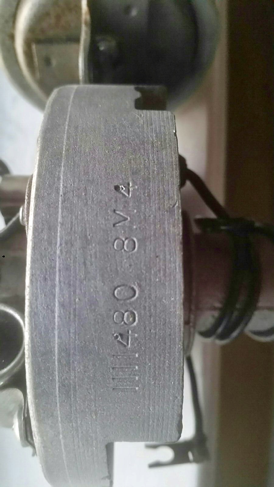

Just making sure it real. Been in garage for years and was rebuilt and stored. What's the value of this? Thanks

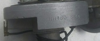

Default Larger Picture
Close up

Default 1111480
it does not look real to me

Hard to tell from the pic, kinda grainy. It looks to have been sanded down, some of the machine marks are gone. Check the advance plate and post a pic of it. I’m reserving judgement.
My opinion is the same as Little Tommy's. Hope you aren't too deep in it.

fake

restamp the 4 is wrong

4 8 and 0 are wrong
