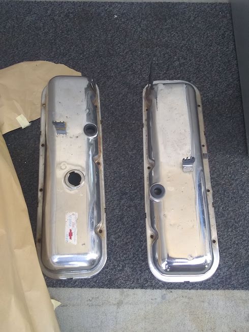

Only thing I would change is the heater core. After i traded my first Z/28 to my brother in 1972 or 73 he put a 427 in it. The MT valve cover actually touched the heater hose fitting.
Frankly, if you have a SB heater cover, you already have the right cover. Just punch two holes for the BB heater core. Just not worth the head ache.

Update:
The last 48 hours have been great. I sold some parts and acquired some much needed parts.
I just picked up my spare pre October '66 frame from being straightened
Picked up a bunch of needed parts many from AnthonyS Thanks!
-4 Piston front calipers
-Wheels
-BB Clutch Fan
-BB Pulleys
-Dist Cap
-Battery Topper
-Front Manifold Lift Bracket
-Flywheel
-T3 Headlights
-163 Intake Square Port
-Valve Covers
-Rear Drum backing plates+drums
-Power Master Cylinder
