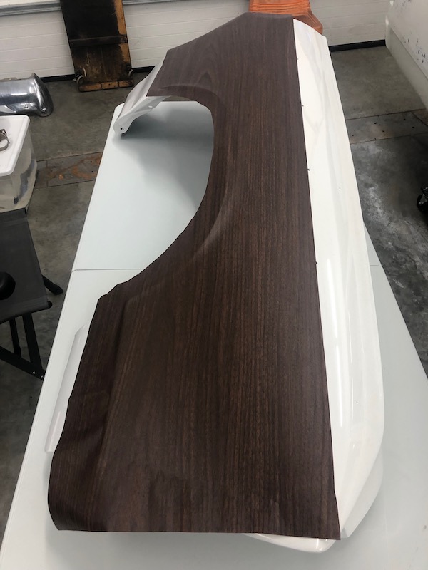

Here is the RF fender with the vinyl laid down, but before trimming and wrapping the edges.
With the vinyl applied, ready for the "Bling"! 60 some feet of body side moldings, polished door handles and lock cylinders, so now the door panels etc. can be put back.

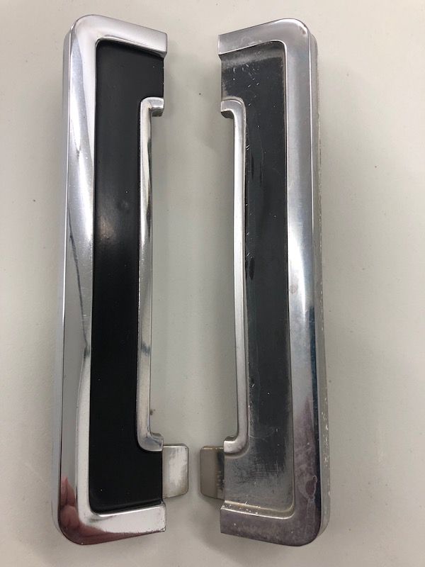

NOS wagon door edge guards are cheap on eBay, so the beat up originals were replaced. Rear w/o moldings are impossible to find, so the originals were cleaned and installed, they have a few minor dings.

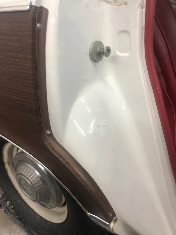

Another feature unique to this car, these metal trim strips to finish off the vinyl inside the rear door jamb.

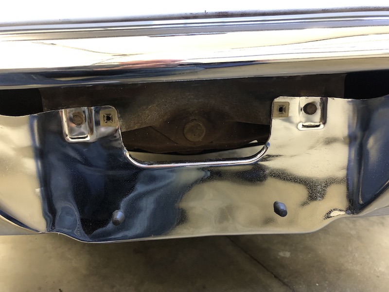

About three hours of hard rubbing with chrome polish brought the bumper around to a shine much better than I expected. New, un-polished, stainless capped bumper bolts had just the right finish to match. The original license screw nuts and rubber bumpers are in great shape. This is the original bumper, still riveted to the center bracket. I understand that 1st Gen Camaro's the rivet head is on the face side, on Chevelles the head is on the back side.

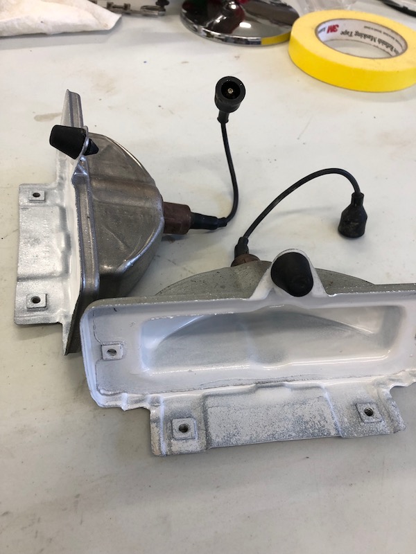

The original CA tag and frame were cleaned and installed. The backup lamps were given an Evapo-Rust bath, cleaned, and the white paint replicated, finished up with NOS lenses.
