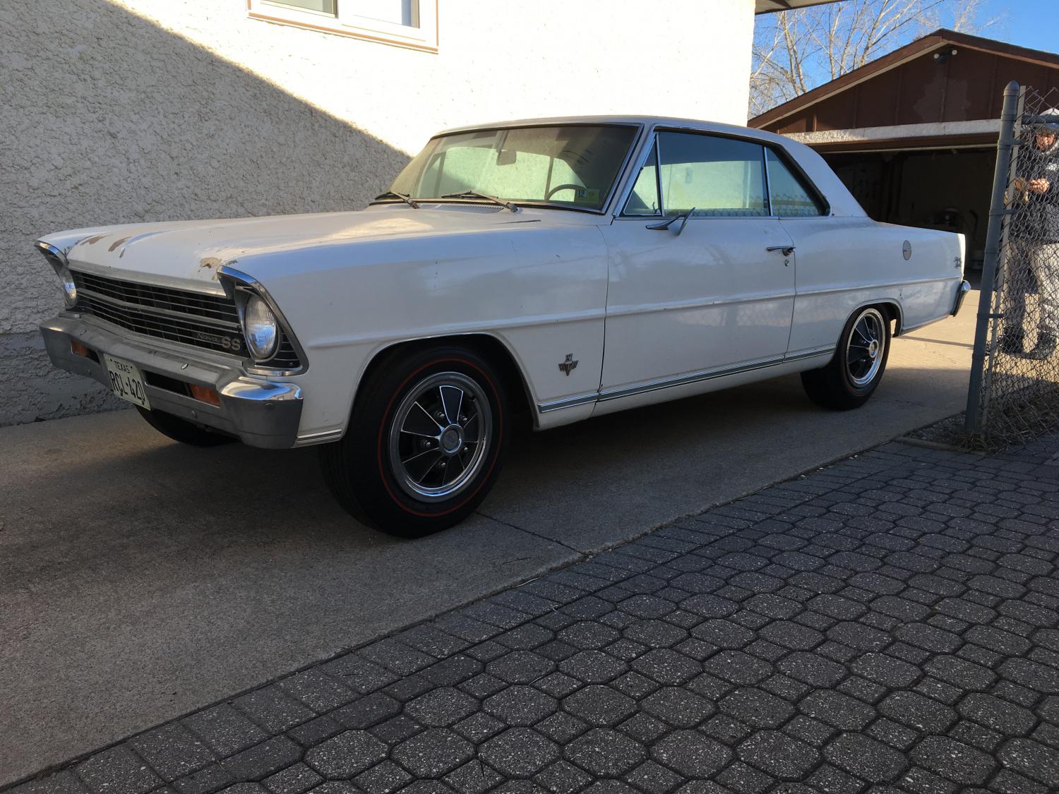

Originally Posted by L78_Nova View Post
The Saga of the Green Bastard (1970 L-78 Nova Restoration Thread)
1st place Dereck’s 1967 Nova SS. This is an original Texas Gem with “ZERO” rust!! Has some bruises and needs lovin but very COOL car original 275HP 327 Factory Air & Power steering. It would appear to have been stored inside since new. I actually knew the previous owner and got out of the way for Dereck to buy this car because I knew I would just never get to it. That’s around the time when Dereck and I became friends.
Highlight ; EVERYONE WANTED TO BUY THIS CAR! and it was the weekend trunk bar and Snack shack!
Attachment 211882
Attachment 211883
Attachment 211884
A slight correction Gary, coming from the owner prior to Dereck! The car is originally an Arizona car, went to Texas, then Nebraska, then Canada!
