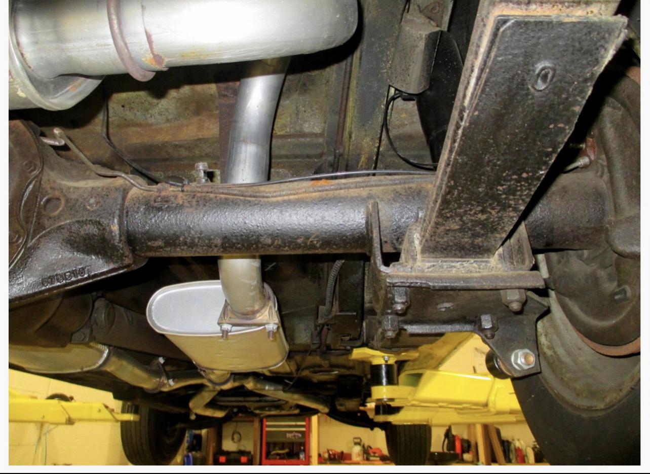

A freind and I were just discussing this the other day. Would appear on this car the black was sprayed after , coating the ends of the exhaust when hap hazardous eating from behind? As per the assembly manual the area around the brake drum ti backing plate is not supposed to get any paint in it so they stopped around the bolt in flange . Axles ends should be free of paint. This is my understanding anyway

Top is an unrestored 69 bird

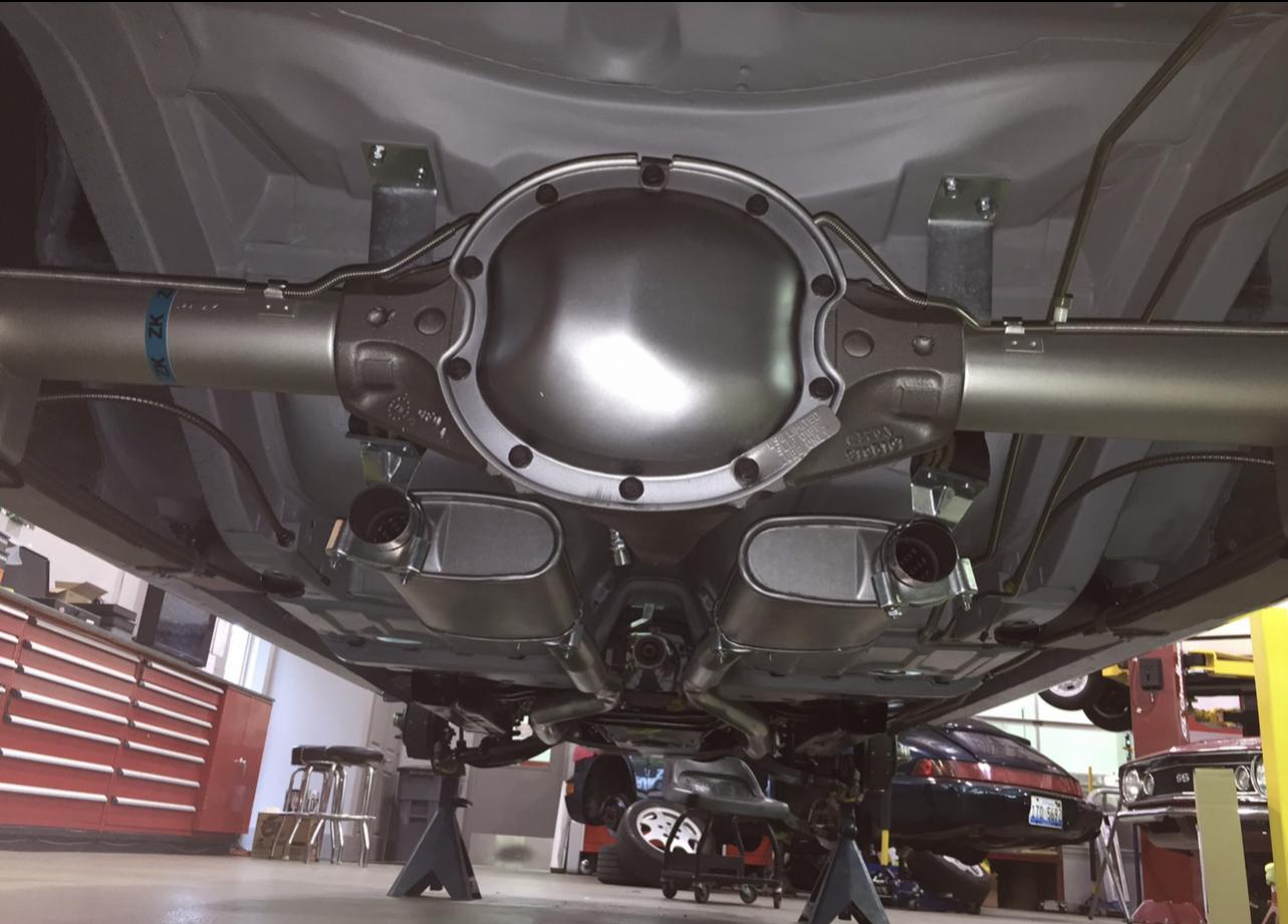

Next two the low low 9k mileage camaro recently on this site,

That's correct for a Firebird, not a Camaro.
Camaro axles, backing plates and drums were painted by the axle plant. There are several other vintage road test pics that show this.
