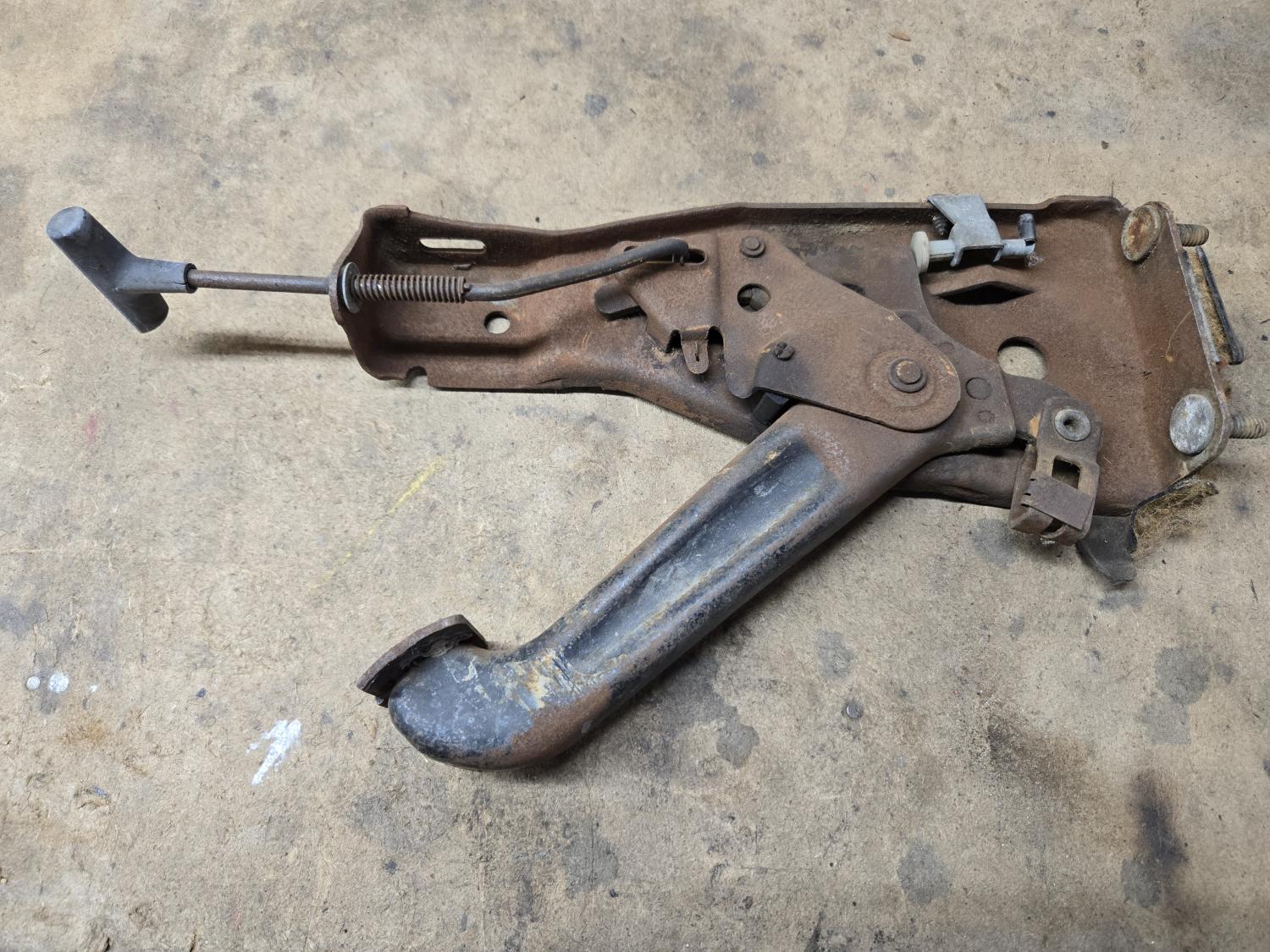

Default Parking Brake
With the cooler days its time to work on small things. Park brake assembly was in good shape.

I want to say thank you for sharing your incredible talent with these cars with us! I look daily for updates on your builds.
Do you have a trick with restoring the plastic pull handle on this Emergency brake handle or will you replace it ?
Sometimes you have cars you can restore the old piece. With more southern clean cars most plastic and rubber is just destroyed. For a car like this it will probably be a repop piece that like many i will rework what I dont like.

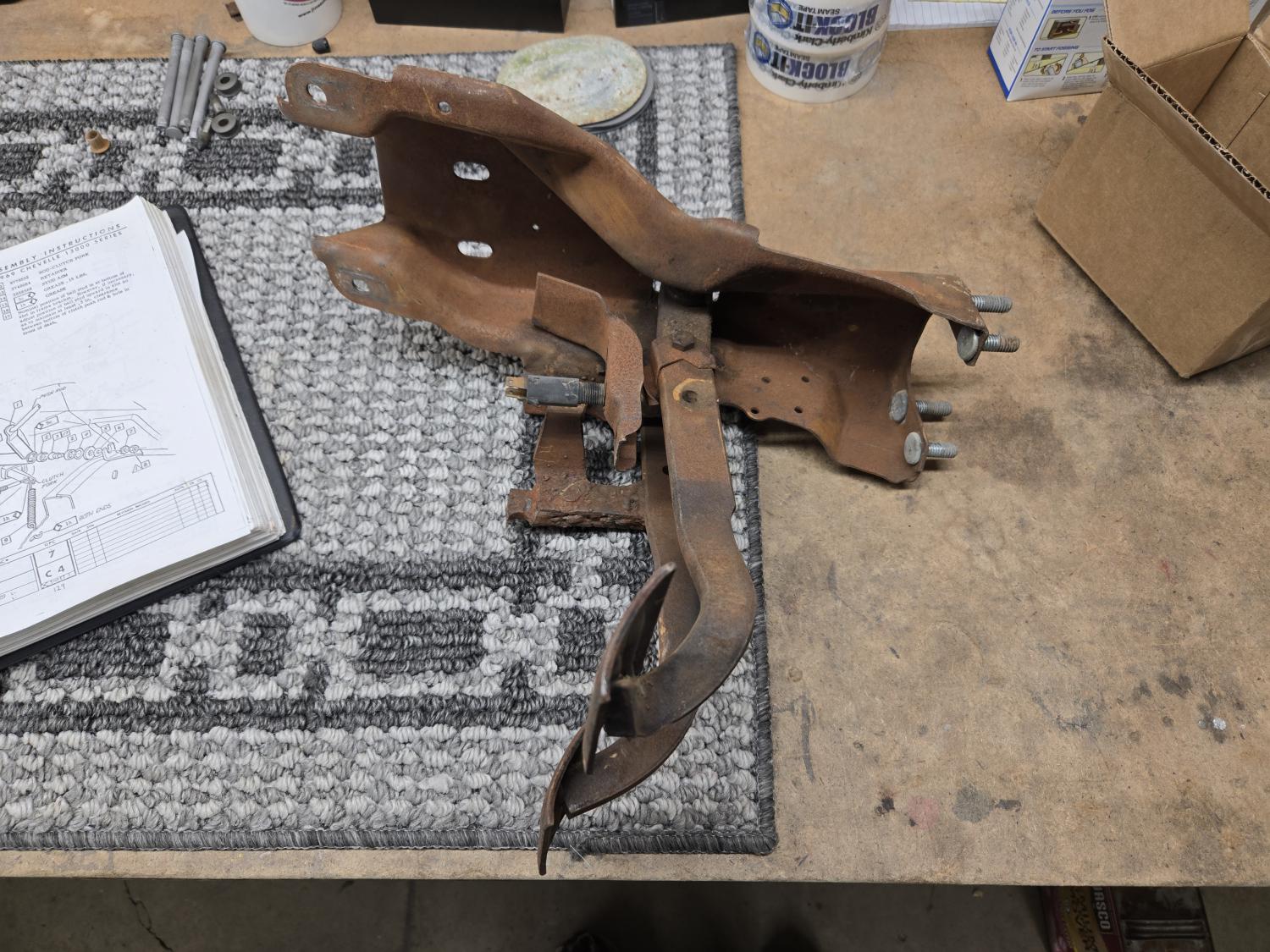

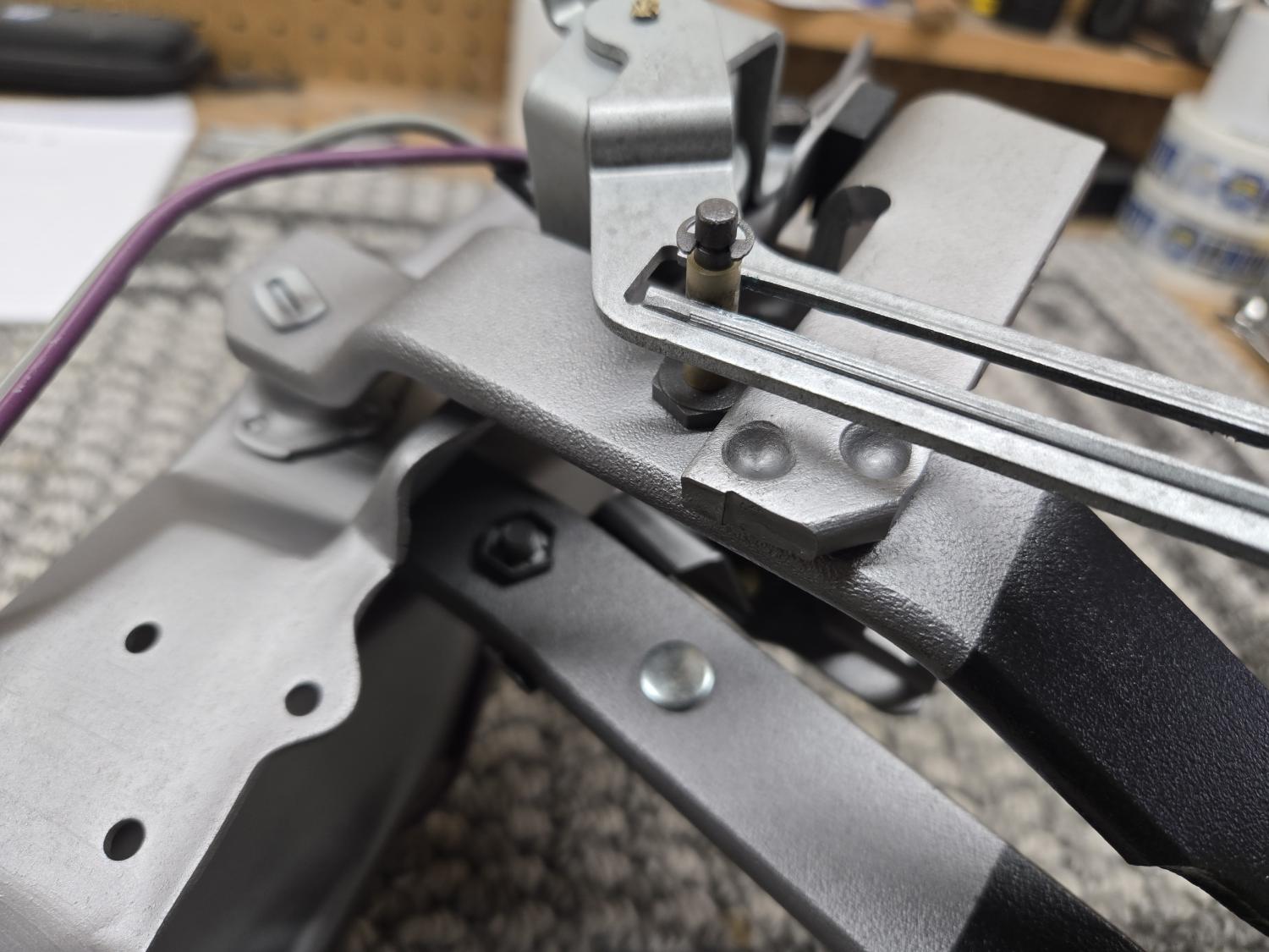

Default Clutch and Brake Pedal Assembly
The original setup was in sad shape. Someone had broken the clutch bracket right off the pedal which I have seen before. Sourced another complete pedal assembly. Complete tear down, bead blast, phosphate and paint before reassembly. Lucky to have found all the little pieces that are part of the neutral safety switch for 69.

Default Restored Before Assembly
Missed one picture
