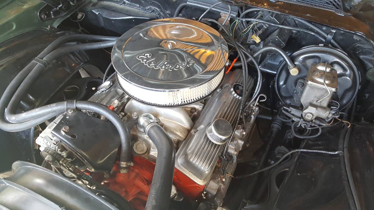

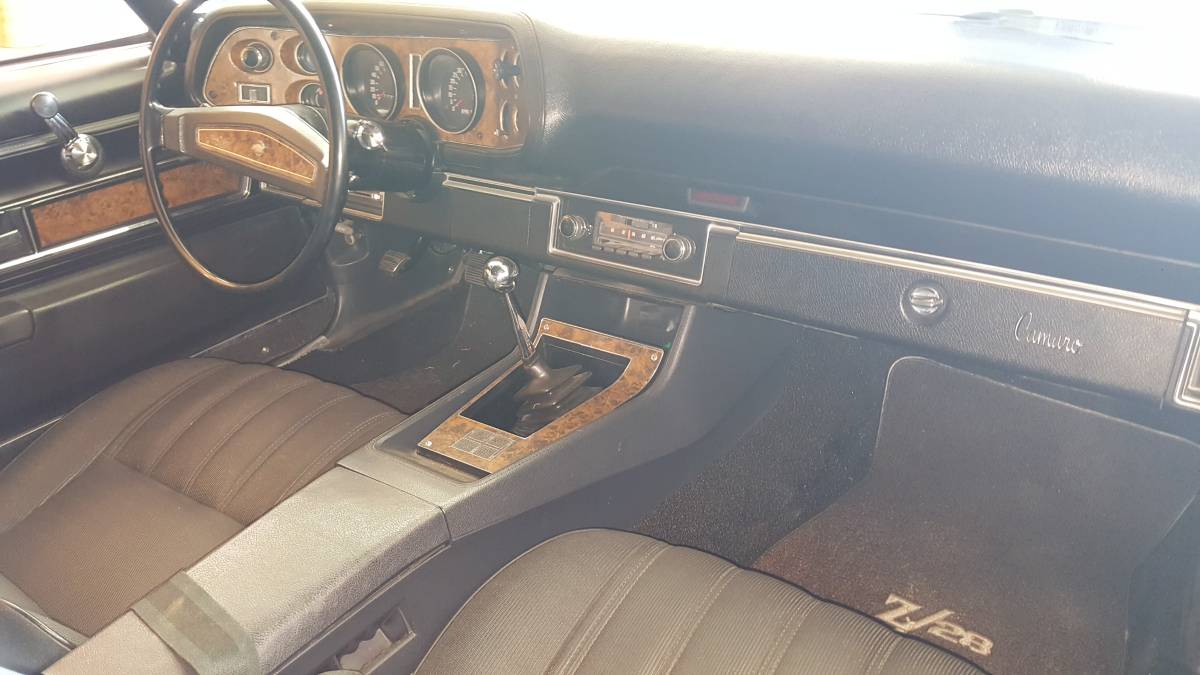

A few more pics

Small observation, but knowledge is good. The 70 dash does not have the seat belt warning light. That, and the valve covers are on the wrong sides.

Dash mounted Fasten seat belt light was on the 1972-1981 Camaro.

I knew about the dash (noticed that today), didn't know about the valve covers - thanks! Love learning new stuff - it keeps me honest!
