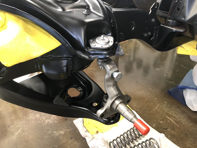

Originally Posted by enio45 View Post
nice rivot job lloyd!
..I know a guy...

Originally Posted by 302moz View Post
The a arm in the picture has a 67 , 68 dome style ball joint . I thought Lloyd was restoring a 69?
Here are photos of an original ball joint I removed from the car, my 1969 RS/Z. I replaced them with the same style.

Originally Posted by Lynn View Post
When was your car built, Lloyd?
Its a 2B Norwood car.

Default Ball joint
Those are not the same . If you clean the grease off you can see the difference. The rivets look good .

Default Ball joint
The picture Lynn posted is the correct 69 ball joint.

You might like this one better which is what's installed on my 69Z restoration:
Nice detail Lloyd those are the correct 69 assembly line ball joints. John k. Is correct....

Lynn has the correct 69 ball joints. The one Lloyd used are later NOS and are different with the (5) five spot welds.
