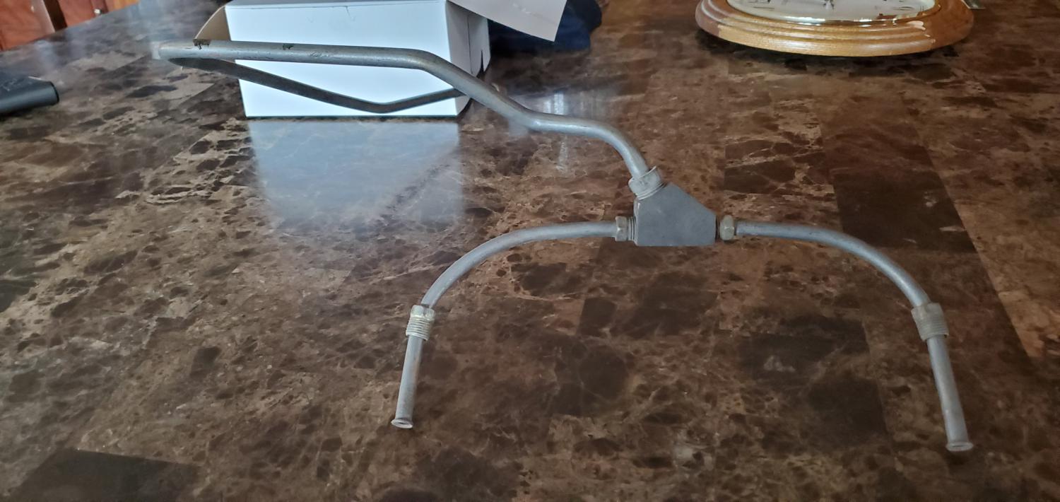

I dug out the fuel line I picked up years ago. thoughts?

Hi... The valve covers are good, the fuel block good. Remember what I said, you NEED the correct distributor shaft and top cam to complete the deal.
