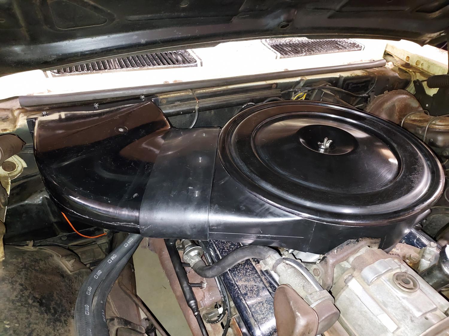

  #14
Old 05-05-2023, 02:22 AM
dannystarr dannystarr is offline
Join Date: Jan 2014
Posts: 511
Thanked 582 Times in 172 Posts
Default Cowl Plenum
Got my galvanized tie wire out and made some staples. Marked everything with small sharpie marks. Took it off, lined up the marks and punched the boot. Installed the 6 staples and put the unit all back together. Ready to roll!
Fun Trick..... FYI wrap your wire with duct tape all around except the top. Pull the wire from the inside top as needed. Works great. I go to other shops and see giant nightmare rolls of wire falling all apart in many directions. Danny

  #15
Old 05-05-2023, 04:45 PM
black69 black69 is offline
Join Date: Jan 2007
Location: Around Chicago
Posts: 1,474
Thanks: 35
Thanked 193 Times in 63 Posts
That looks so dam good, I would kill for that metal air cleaner for mine. Put me on your list for most likely suspect if you leave this car un-attended
