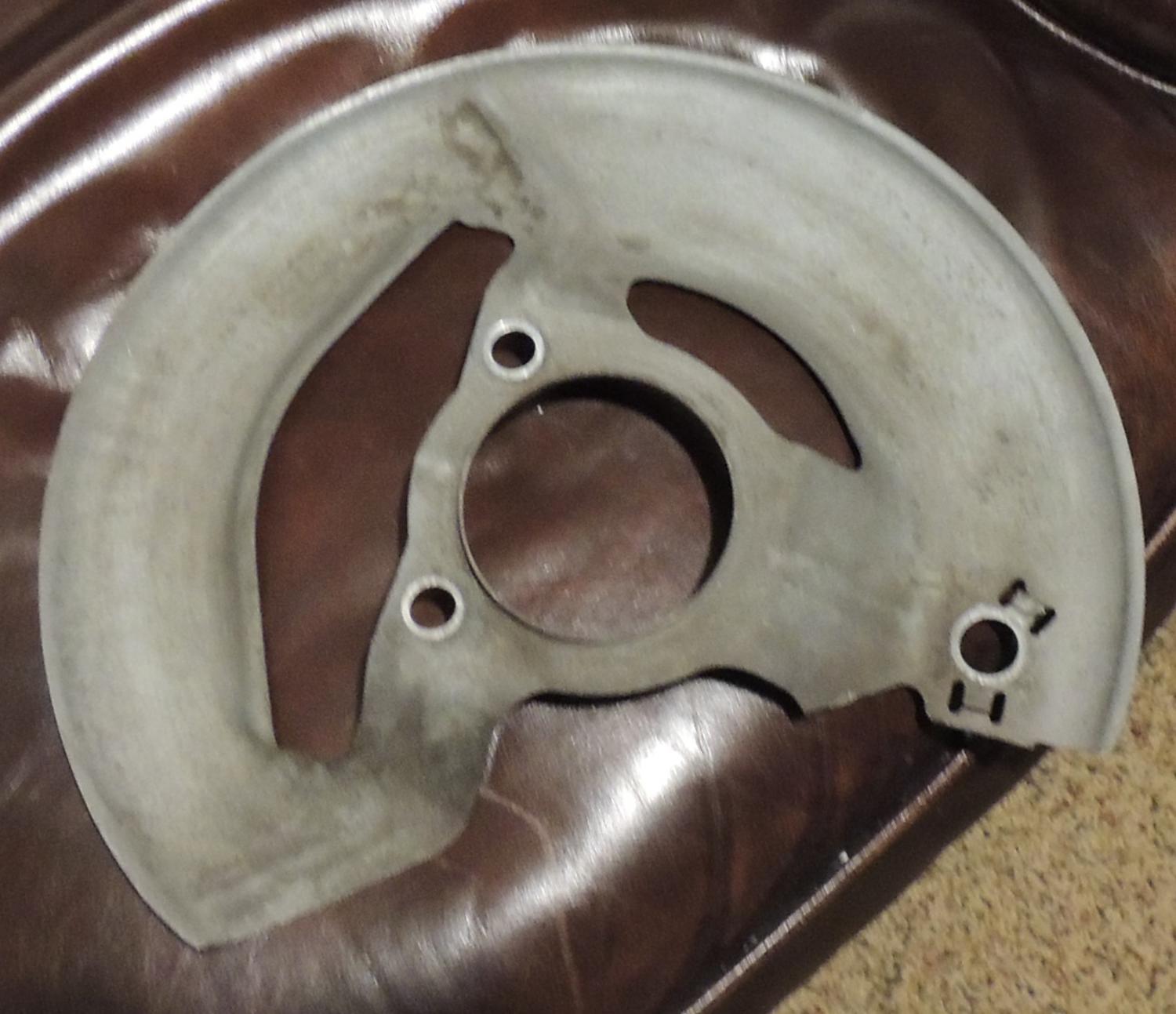

Top Two pics are 2nd Gen Camaro NOS 2nd design with Rolled Edge (not Sharp)
Bottom Two pics are 70 Camaro Survivor ..........
I have always thought these were stamped form Galvanized Sheet....but wont argue
with Dave about non rusting edge............

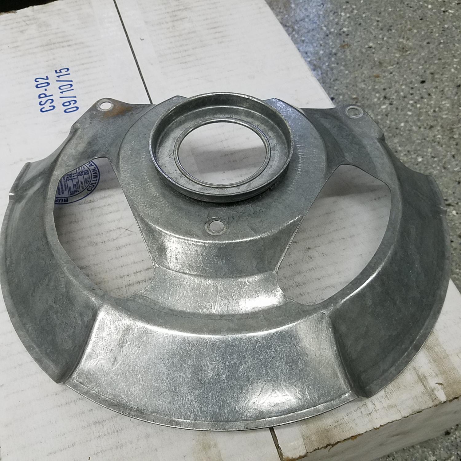

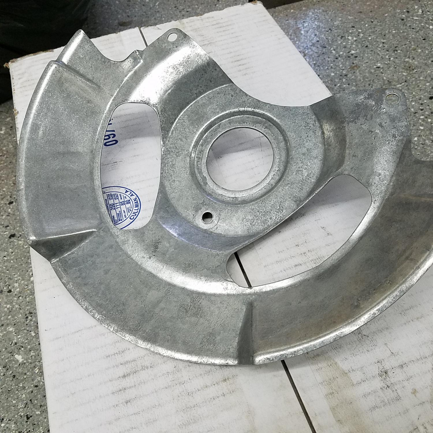

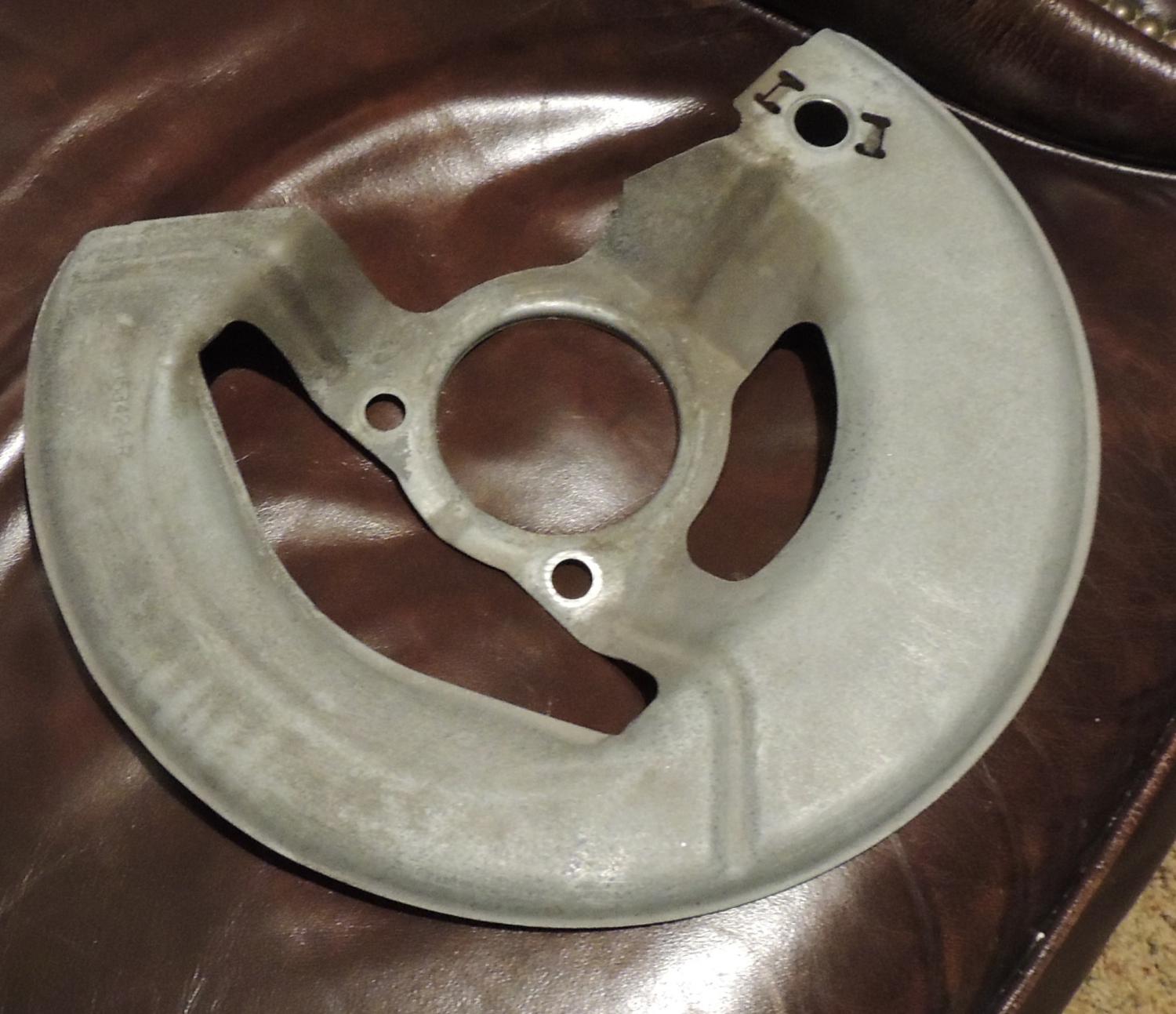

Here are pics of the RF dust shield.
Sadly, the LF is not usable. But, I have a spare. Just haven't tried cleaning it up yet.
I may be searching for a survivor LF.
Glad to have two pristine rears.
Frankly, I cannot tell just by looking whether these are cad plated or galvanized. I am certain they are not hot dipped galvanized. That process leaves a very distinct pattern. Just LOOKING at them without any kind of chemical analysis, they COULD be electroplated galvanized. Hard to tell on a 54 year old part!!!
Roy S told me:
"Front: dull cadmium without dichromate conversion coating. These tend to get chalky look to them with aging.
Rear: punched from galvanized metal sheet, sheared edges are bare steel from the shearing action which could and did rust."
I let this one soak in solvent (Crown PSC1000) for about a week; then scrubbed on it with a soft scotch pad. As you can see, there is still some discoloration on it. I didn't want to scrub hard enough, even with a fairly mile abrasive, to disturb the original finish.
The Following 2 Users Say Thank You to Lynn For This Useful Post:
