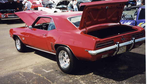

Another 69 with 275 -60 radials on 15x8. Car ran 14x6 front with 195-75 or 205 -75 radials. Just remember the fron tire were too small in width. Rim is wider than tire tread so you get the bulging sidewall.

Nice photos-- I also liked a slight rake on a car.--JoeG [img]/ubbthreads/images/graemlins/beers.gif[/img]

Whitetop, You've got the look down perfectly there! [img]/ubbthreads/images/graemlins/beers.gif[/img]
