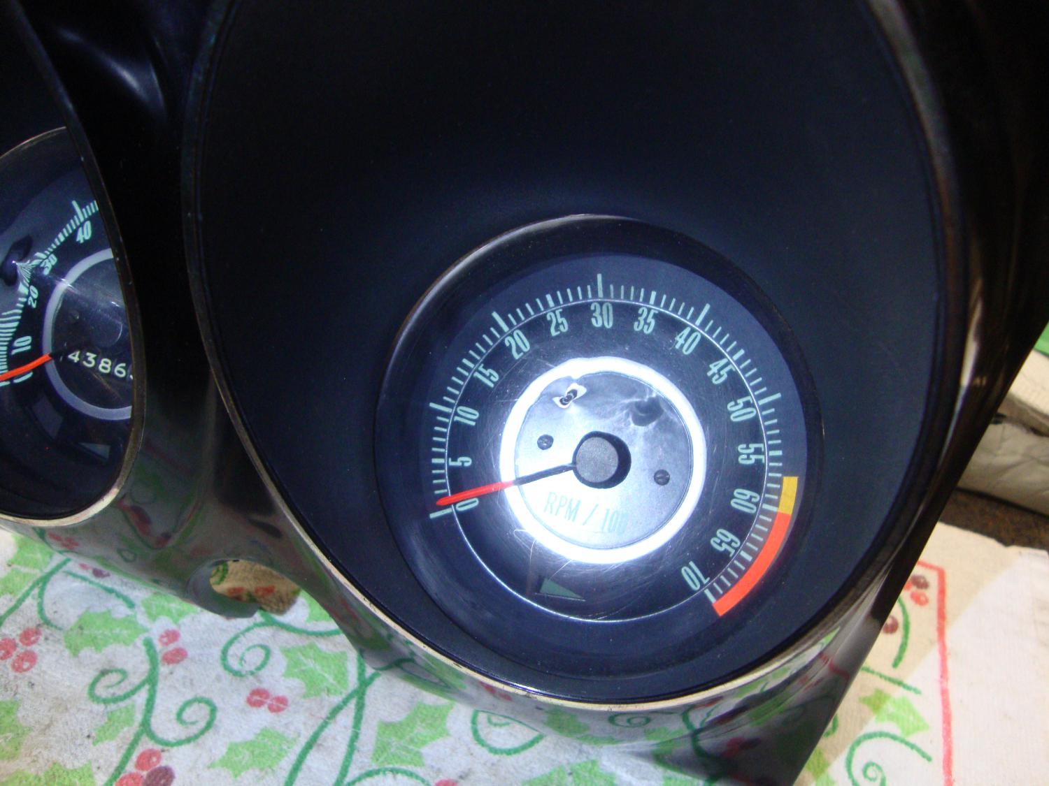

Hey glad my post helped but I just followed Jason's @SuperNovaSS tip. Looks like Johns tach needle may rest a tad above zero like mine.

All gauge readings are now accurate! The super wide ratio trans is a game changer. I like the starting line ratio yet with the 3.31's I can still cruise to work on the freeway. My morning commute is a little over an hour and I'm enjoying every minute of it. I get the nods, waves, and honks throughout the drive. I'd like to think seeing my car is like a breath of fresh air for the other commuters, at least that's how I feel when I see a cool car on the road.
