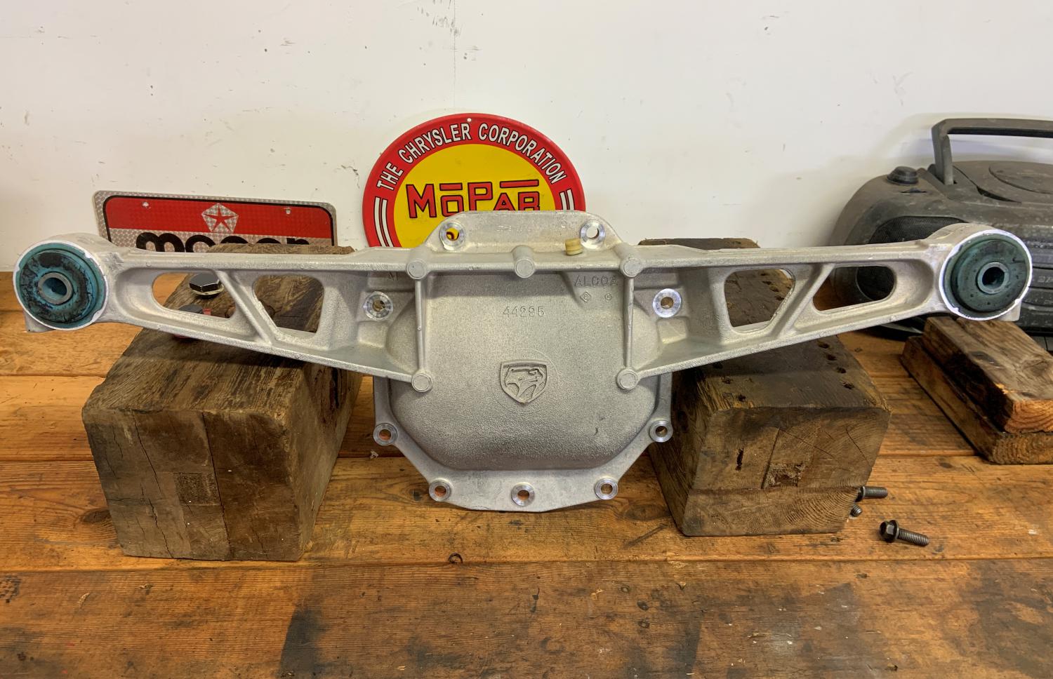

NOS rear diff in place and ready for winter!

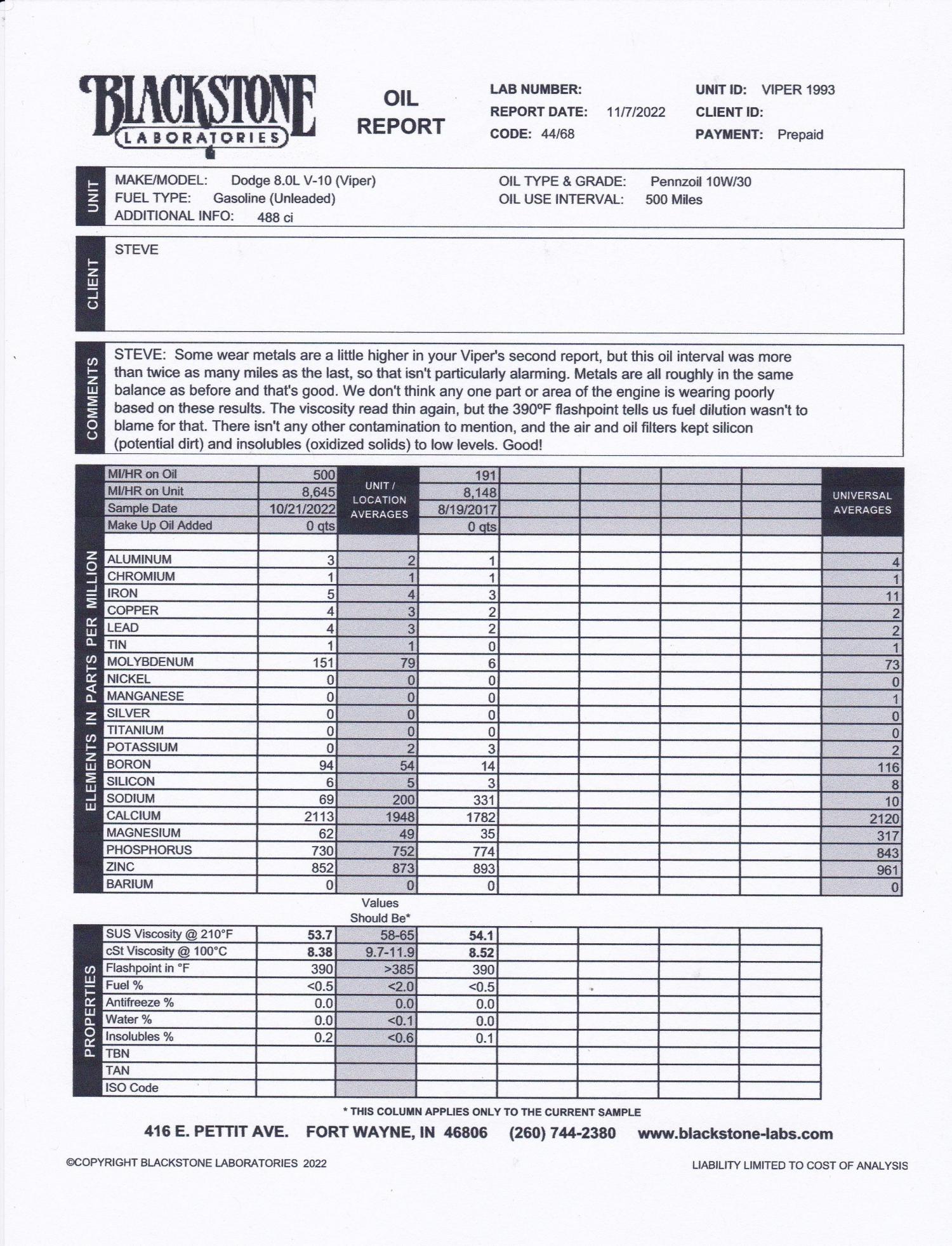

I got the engine oil sample results today and everything looks good for 500 miles and 5 years of use.

At least for the moment I have my wall art nice and clean and ready to hang up. It has been soaking in Purple Stuff for the past 5 days. It cleaned up nicely. Awaiting the report from the machine shop next week.

Looks like Blackstone was right on the money. It was devouring the bearing rollers in the main pinion bearing, which was contaminating the fluid with iron.

And the shiny, clean diff with the 3.54 gears all reset and ready to go.
