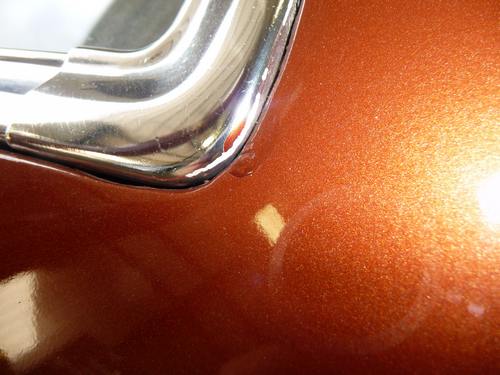

This is stuff that I have always assumed a prior had done to a car when I saw this stuff but the story of this car is pretty solid. And Norman already said he never bothered to go back to the dealer to get the missing mirror so I doubt if they did it at any time after he bought the car.

Weatherstrip goop...Do I get points deducted ?
